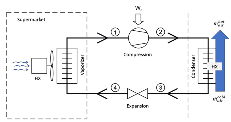

Please provide a schematic diagram of what you envision the system to be.
A schematic overview of the system is attached to my post.
Sorry. I really don't follow what you are trying to do.
Please excuse my inaccuracy.
The subject of the study is an existing supermarket with a cooling system (load: 12-20 kW) based on R290 and a solar roof.
An A-CAES (adiabatic compressed air energy storage) is being developed to temporarily store the surplus PV electricity so that it can also be used at night. When the A-CAES is discharged, the compressed air is expanded and the air cools down. This cold air has a mass flow rate of 120 kg/h at a temperature of 0 °C.
This is to be the starting point for developing a refrigeration machine. My focus is on the economic consideration, which is why the amount of energy saved by the original cooling system is relevant for me.
Currently, I have the load profile of the cooling system from the supermarket and from the PV generation. I hope this clarifies my question.

Some.... In the diagram you appear to be blowing the cold air across the condenser of an air conditioning unit. Why? If the air is at 0C already, the compressed air system is already "a refrigeration machine". Why can't you use the cold air directly? Just blow it into an air conditioning duct, to mix with the return air to the system?
Back of the envelope, 120 kg/hr at 0C is roughly 1.2 kW of cooling, which for a typical air conditioner costs about 260 W of electrical input. That's about what you could save by injecting the cold air into the return air duct of an AC unit.
