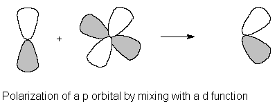

Can anybody explain the difference between orbital role in hybridization and orbital role as polarization function? What is the interpretation of orbital polarization? Is it just electromagnetic quantum interaction achievable with mathematical description, giving the observed results? Or could it be interpreted with e.g. Coulomb law?
Anyway, the presented result of polarization function is (inexpertly) similar to hybridization - different shape of final orbital:
Of course, but the admixture of d-type polarization functions is only some percent. So this is far from forming a set of hybrid orbitals each containing an equal amount of d-functions and all participating in bonding.
If you express the d-functions in terms of atomic d-orbitals, they contain also 4- 5- and higher d-orbitals.
Hence, all in all, the virtual unoccupied orbitals still are mainly of d-type.
Btw, to get a reasonable description of bonding in some sulfur compounds, you even have to include f-type polarization functions
