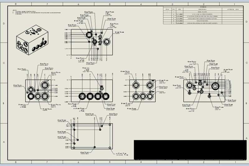

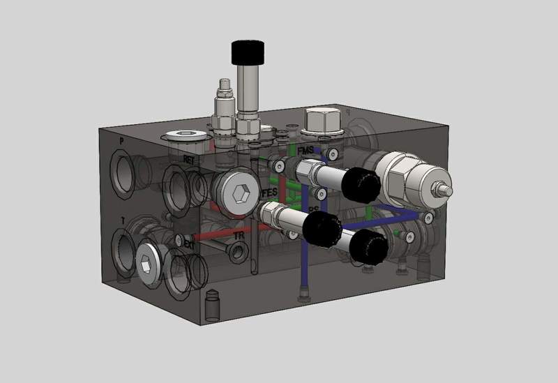

Because the circuit is going to require a lot of valving we're going to need a manifold to pack all the cartridge valves in. Otherwise you end up with a bunch of individual valves that you have to hook together with tees/fittings/hose/tubes. It gets really ugly really quick. A single manifold can house several hydraulic circuits into a small package. I'll send you an example later.

Yep, I plan on designing the manifold and drawings. I would suggest "www.hpsx.com"[/URL] to manufacture it. They've made dozens of manifolds for me over the years and have a top notch machine shop.
  • #58
drankin said:
Yep, I plan on designing the manifold and drawings. I would suggest "www.hpsx.com"[/URL] to manufacture it. They've made dozens of manifolds for me over the years and have a top notch machine shop.[/QUOTE]
Excellent. Any ballpark idea on what it costs to have that done?
Maybe around $1000.
