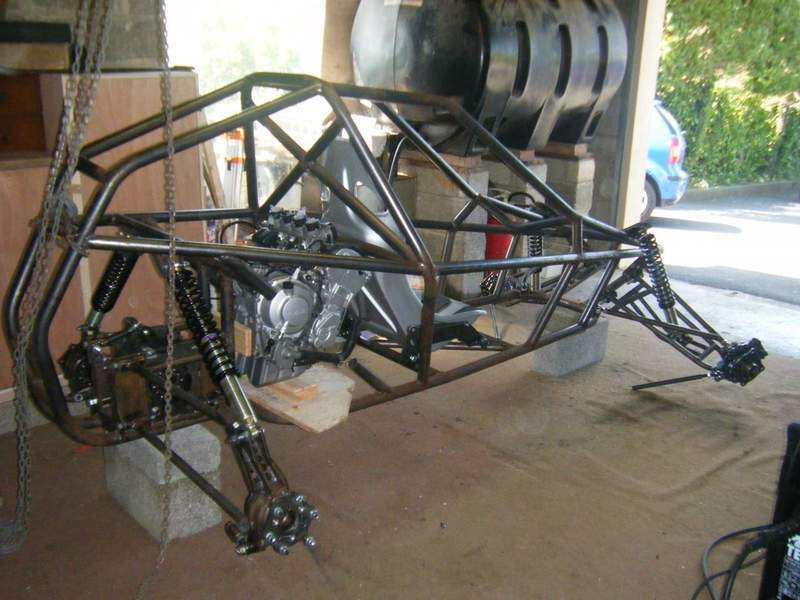

  • #79
Here is a picture of the frame the way it sits. Haven't done much to it till we figure out what components we are using. Once we figure out the hyd motors, we can build the suspension.

  • #81
Nice looking frame! How much does the engine weigh?
  • #82
Thanks. The engine fully dressed weighs about 500lbs. The pump 220lbs, total of 4 motors, 84lbs. Wheels and tires, 120lbs. Frame so far weighs 180lbs but that will go up. Originally we planned 2000-2500lbs with 2 adults, so we'll see how close we come.
