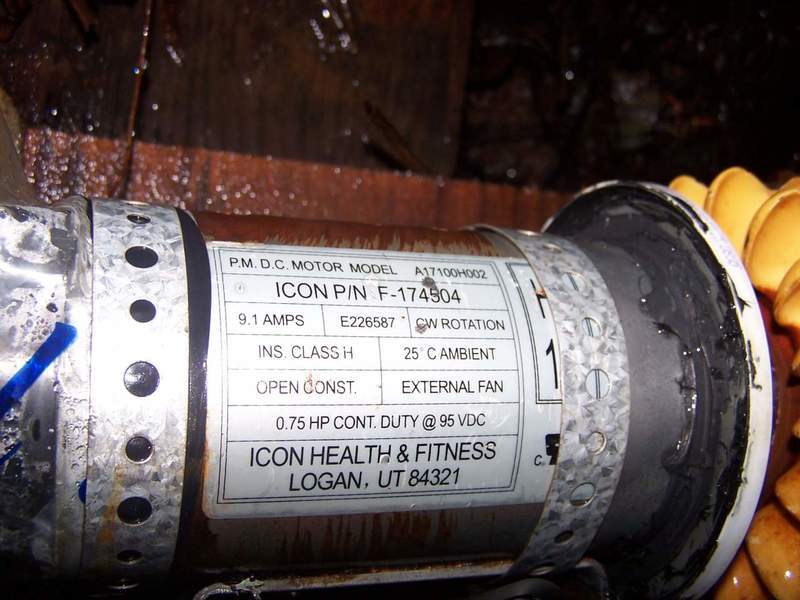

Great, thank you Russ! That link is a mouthful. I'll read that through, and also put together better info for the "hardware". Meantime:
I have a couple different permanent magnet DC motors. (one can be fixed up while the other is wearing down). I just make the jet as big, and fast as I can.

I need to find the ideal RPM for two different DC perm-mag motor/generators. That will need to match my wheel. Might be hard to find anything smaller than my 5 1/4" though.

Can I “reverse engineer” (for lack of a better term), the characteristics of the motor/gen. by metering it's current draw under load and somehow measuring it's RPM? Sheez..A known load. String winding on a drum could provide both load and RPM.
Right now matching my work to that wheel and that jet is my issue. If the above motors aren't reasonably close enough I might find another, or a larger wheel may be affordable.

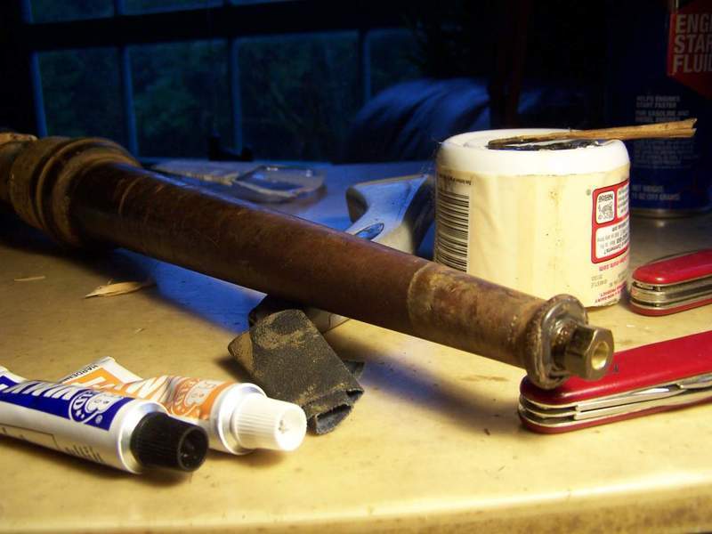

Below are some specs I found on the Ametek motor/Gen, I have here in the house. Once while it was running, I left the circuit open a second, (makes a siren sound down there in the gully when it freewheels). I then hooked it back to the house circuit forgetting that the batteries where not connected. I discovered that the 60+ volts will fry my radio, even when it's off! (memory ect.)
Rpm...Open V...Shorted Amps
100...3.48.....1.18
400...13.92....4.51
500...17.4...5.5
600...22.88....6.30
Then I found that it will go 60+ open at 2-3K RPM
I wonder how "shorted", correlates with the resistance of my battery system. Could this motor/gen. be near enough to optimum for my system with only impeller size as the variable?
