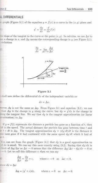

Honestly I am reading a book writing "dx equals [delta x]". It is called "Mathematics Methods in the Physical Sciences" written by Mary L.Boas. Here is the page talking about this.
Well if dx is the infinitesmal change in x, how can it equal [delta x]? I start to get more confused.

The definition given in that page seems to be an ok definition, although it does not agree with other definitions given in other sources. Welcome to the definition jungle, Lucien1011.
Equation 2 is a standard method of introducing the concept of differentials. But I don't like the paragraph where she writes "but dy is not the same as delta y". I think that should be reworded.
