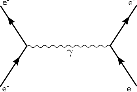

Even the poster boy of modern Physics invented the Feynman Diagram without making it clear that it's just symbolic and that it's not a 'picture' of what's happening.
That squiggly line says nothing at all about the nature of the EM energy as it goes between the (actual) particles. I guess it must be that tangible particles are more approachable than airy fairy waves.
Huh?
I don't think you mean Ernest Stückleberg. If you meant Richard Feynman, the paper where he introduces them, The Theory of Positrons, PR76 6 p.149 (1949) is very clear on the issue. The fact that there are an order of magnitude more equations than diagrams shows where the paper's emphasis lies.
It's obviously not clear enough but that's no surprise. The Feynman diagram is a very elegant way of showing the logistics of interactions but it should not be interpreted as a photograph of what happens. My earlier point was that this (very attractive) interpretation is just what people make, which is where the problem starts. With the 'Feynman badge' it is even more likely to be held onto with grim determination. It's a sort of 'ad hominem' reaction; "My interpretation is what Feynman said so it must be true".
