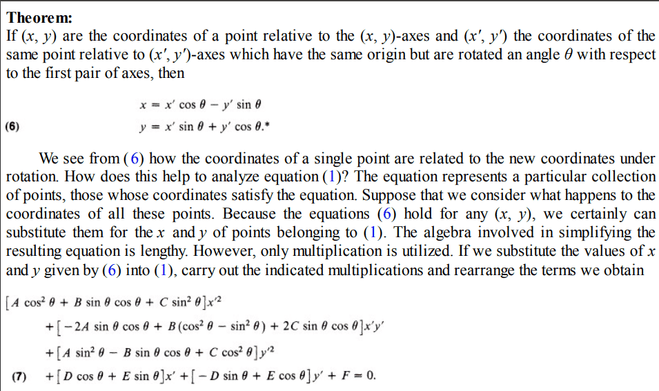

Reduce to standard form and graph the curve whose equation is ##x^{2}+4 x y+4 y^{2}+12 x-6 y=0##
Relevant equations:

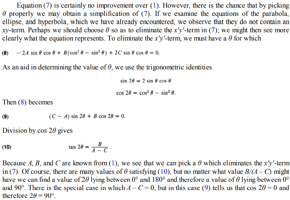

For the form ##A x^{2}+B x y+C y^{2}+D x+E y+F=0## I need to carry out a rotation to remove the xy term using ##\tan 2 \theta=\frac{B}{A-C}## (see specifics in spoiler below). In doing so I am having difficulty in determining the value of ##\sin \theta## and ##\cos \theta##
It appears that I needed to use
\begin{array}{l}
\cos ^{2}(\theta)=\frac{1+\cos (2 \theta)}{2} \\
\sin ^{2}(\theta)=\frac{1-\cos (2 \theta)}{2}
\end{array}
To get the values of cos and sin in the solution. I was not familiar with this formula :nb).
