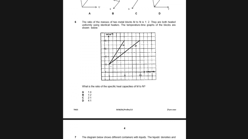

Hello! I need help with this question. The answer is D but I don't understand why :/ Thanks!
Please post your attempt .
Hint : What is formula for ΔQ ? What is power provided ?

Why is Q1 = Q2 ?
Heaters are identical , and so power provided by them will be the same . The heat absorbed by the objects in some time ' t ' will depend on their own properties . It will not necessarily be the same for both .
Try again .
Hope this helps .
Oh Yes.. I read the question wrongly. I thought amount of energy provided is the same.
