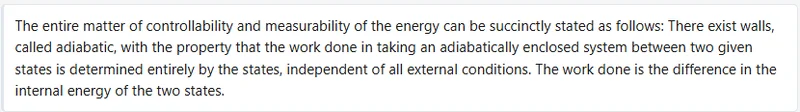

In section 1-7, titled "Measurability of the energy", Callen claims that given certain walls, called adiabatic walls, the mechanical work is a state function. In particular, he writes on p. 17:
The entire matter of controllability and measurability of the energy can be succinctly stated as follows: There exist walls, called adiabatic, with the property that the work done in taking an adiabatically enclosed system between two given states is determined entirely by the states, independent of all external conditions. The work done is the difference in the internal energy of the two states.
The particular part of this that irritates me somewhat is the conclusion that "The work done is the difference in the internal energy of the two states.". This is not shown anywhere and thus makes me wonder how one reaches this conclusion purely based of the postulated properties of the internal energy. I have an attempt to derive it below, but I am not sure how correct it is and there is a detail which is not entirely clear.
Let A, B and C be three equilibrium states of an adiabatically enclosed system under consideration accesible to each other in that order (A->B->C). For simplicity, let us assume that the system is simple and thus can be characterized completely by U, V and N in equilibrium.
Suppose that A, B and C have identical chemical composition and volume. Then, between each transformation, what must have changed is the internal energy. Clearly then, the changes in internal energy are functions of the adiabatic work,
$$\displaystyle \Delta U=f(x)$$
for some function f. Because the internal energy is a state function, it must be true that
$$\displaystyle f(W_{\text{ad.}}^{A\to B}+W_{\text{ad.}}^{B\to C})=f(W_{\text{ad.}}^{A\to B})+f(W_{\text{ad.}}^{B\to C})$$
This functional equation is satisfied by any linear map. However, because of the postulated continous differentiability of U, f must also be continuously differentiable (I think?), which leaves us with the solution below, for some real k
$$\displaystyle \Delta U^{X\to Y} = kW_{\text{ad.}}^{X\to Y}$$
A few questions about this:
(1) Is my reasoning correct?
(2). If it is, is there anything in the postulates of U that forces k=1, or is it merely a convenient choice? Clearly k=0 is unphysical, but other than that, are we technically free to pick any factor we would like?

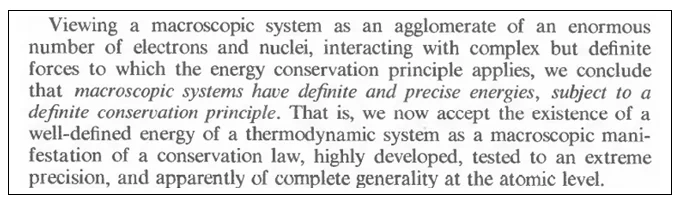

I think Callen’s conclusion follows from his discussions earlier in Chapter 1.
The change in the internal energy of a system during a process equals the net amount of energy transferred to the system during the process. This follows from the principle of conservation of energy.
For simple thermodynamic systems, work and heat are the two types of energy transfer. For an adiabatic process, there is no heat transfer. So, for an adiabatic process, the work done on the system equals ##\Delta U##.
Since ##\Delta U## depends only on the initial and final states, the work done in an adiabatic process is determined solely by those states. Therefore, the work must be the same for all adiabatic processes that take the system from a specified initial state to a specified final state.

Even though we need quantum mechanics to describe atoms, we still assume that systems of atoms have well-defined energies and that the law of conservation of energy is valid. On page 17 of Callen, we read
When work is done on an adiabatically enclosed system, we can imagine it being performed by a mechanical contrivance, such as a compressed spring. The work, ##W##, done by the spring on the system equals the loss of potential energy of the spring. Assuming conservation of energy, the loss of the spring’s potential energy must equal the gain in internal energy of the system, ##\Delta U##. So, ##\Delta U = W##.

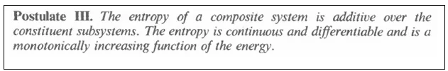

I'm not familiar with any treatments of thermodynamics that prove differentiability of ##U##. I think physicists tend not to worry too much about it. They just assume differentiability. For example, regarding entropy, Callen gives on page 28:
So, Callen postulates differentiability of ##S##.
