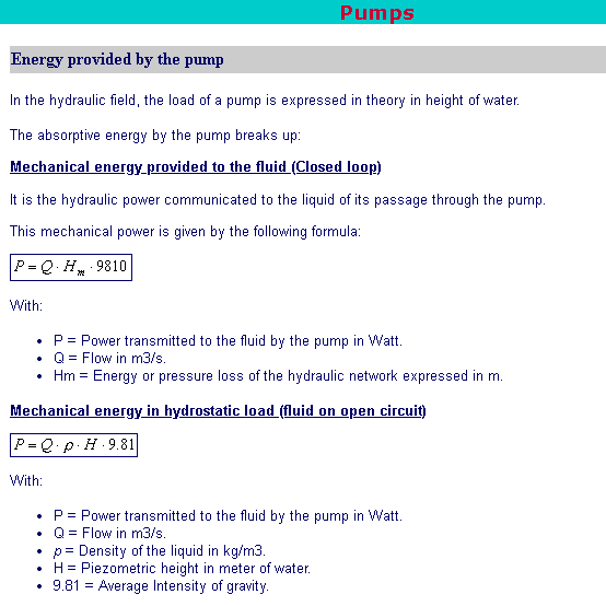

Here's a primer on hydraulic power of a pump. A turbine will be similar.
https://www.thermexcel.com/english/ressourc/pumps.htm
that should give you basic vocabulary.

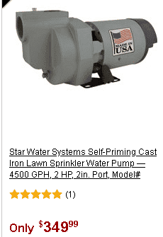

Go to the hardware store and look at a 2hp yard sprinkler pump.
