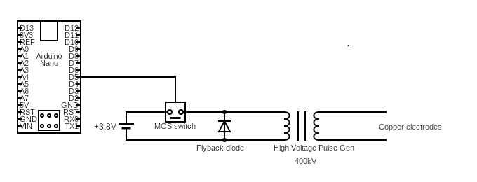

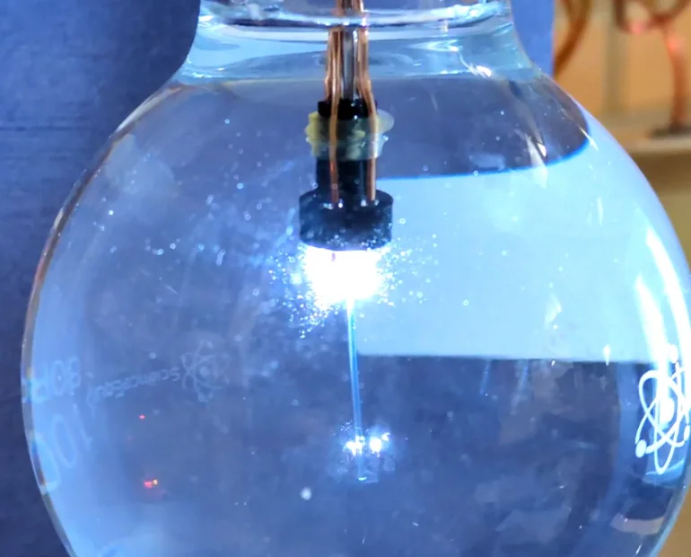

I am trying to do some experiments with cavitation bubbles by generating a spark under water however I am having some trouble and was wondering if anyone would be able to help or offer some advice.
The problem I am having is I cannot generate the spark consistently. I place the electrodes in (distilled) water, apply the high voltage across them, they will usually spark a few times and then stop and fail to spark again after that.
The setup I am using is described in the following (attached) diagram:
The electrodes are just copper enameled wire with a gap < 1mm. I am using a small "High Voltage Generator Pulse Generator Coil" (goes by other names see this link) of around 1000kV to generate the high voltage across the electrodes. I am controlling a "High Voltage Pulse Generator Coil" with a trigger switch and an Arduino to precisely set the time for the spark. The electrodes themselves are placed in distilled water rather than tap water to avoid potential electrolysis.
Things I have tried:
- different spark durations from 50ms to 2000ms most have similar results
- different thickness of electrode wire from 0.1 to 0.85mm
- multiple strands of electrode wire 3 x 0.25mm and 2 x 0.63mm
- different quality distilled water (currently settled on high grade conductivity <= 1uS/cm)
- different coils, I also tried a 400kV coil with similar results
Although I have not read or seen anyone generate a spark with this "High Voltage Pulse Generator Coil" I thought it would be possible based on this paper which generated a spark using a small piezo electric igniter. But even so I am not sure if using the "High Voltage Pulse Generator Coil" is the problem so curious to hear thoughts on that.
I could try another circuit or setup, but was hoping to first get some advice and try to understand the problem first.
Thanks for taking the time to read my post.

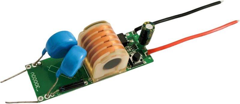

Is this a joke or a spoof? I looked at the spec on Amazon and it seems to claim hundreds of kV and 5A output (nearly a Megawatt!!). It's reasonable to suppose this gizmo can make sparks for gas cooker ignition etc but that little box with thin wires coming out of it really doesn't look the part. Look at the care with which an old CRT in a colour tv manages to cope with very high volts.
Have you any way of measuring what your box actually produces? Good fun if you are careful of secondary accidents when the spark hits you and makes you jump.
Teflon insulating film has a breakdown voltage of 60 to 173 Mv/m. So 700Kv would likely damage that insulation. But the product comes with warnings that it will be damaged if the maximum air gap is exceeded.
The specified maximum air gap is 1.5cm which corresponds to 45Kv. So, you're right, that's a very theoretical 700Kv.
As far as the megawatt, it's only a megawatt during the pulse - and they do not specify the pulse width.
I also noticed that they show 9 views of this device. And 9 out of 9 are side views. We never get to see what either end looks like. A good look at the high voltage end would have provided more clues about the practical maximum output voltage.
That thing is a high voltage coil driven by a pulse generator. The output of the coil is charging a capacitor through some diodes. When the voltage goes high enough and breaks down the insulation a spark is generated, discharging the capacitor. Then, all over again, few dozen times a second or more.
Weaker insulation means more frequent sparks at lower voltage.
If there is a constant load it may counter the charging pulses and prevent sparks to happen.
So actually the change in the water is a good explanation.
You may try to introduce some currents to the pool to disperse the salts.

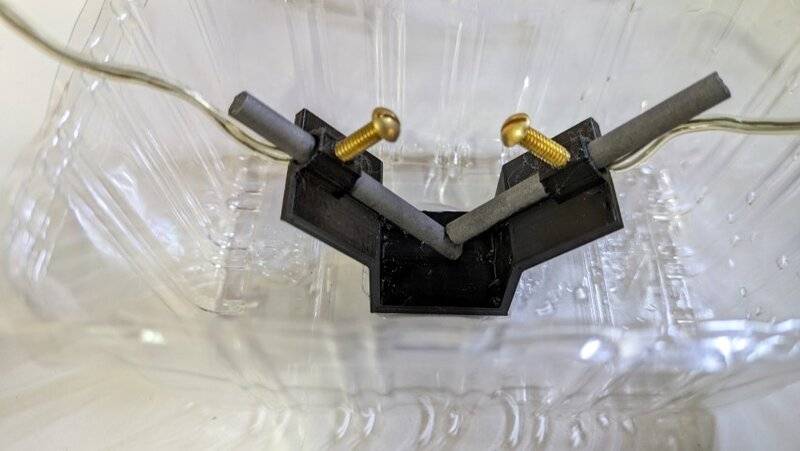

I tried the Carbon rods today, I could not generate an arc from them. I can generate an arc in air, but in water nothing. When I remove the water some of it still remains on the electrodes and unless I wipe that away there is no arc. I attached a a photo of the electrodes. I tried both a tiny gap (approx width of a piece of paper) and then a larger gap approx 1mm.

Thanks for your reply, I am using electrical arcs because they are cheap and "easy" to generate (easy is actually not so easy!). I would like to be able to generate bubbles at multiple and specific locations and so using other methods (laser etc) I think would be more difficult and expensive. There is nothing really about this style of bubble that I care for though.
Try sanding the tips to a point? Might make it easier to arc over.
Or use a couple of sewing needles. Maybe cover them (except the tips) with shrink tubing or tight fitting Teflon tubing to reduce metallic ions contaminating the fluid.
Also, if that rather large electrode holder is wet, there will be a huge leakage path. A glass holder that is kept very clean would decrease that problem; as would wrapping the electrodes with some Teflon sheet.
A higher current voltage source with the fastest risetime you can get would also increase the likelihood of some sparks.
I'm still not convinced about this. Once the arc has struck, you have a very low load resistance. Won't that require a much beefier supply with a low source resistance to avoid the volts dropping rapidly (i.e. a very short pulse length). If your device works fine for an igniter that's because the overall Energy needed is very small.
You could try looking at the pulse with an oscilloscope; how long are the pulses (under load) that you get?
By all means, don't be convinced. It's advertised at 700Kv. But as I said, it's a very theoretical 700Kv. In fact, the insolation and air gap distances will "short" the output before it every gets to even 100Kv.
That thing is just ramping up a cap till a spark ignites. The 'source resistance' is just the cap and some wires.
The voltage drops very fast. But they can 'honestly' promise very high (peak) current...

Of late I am not having much success generating bubbles at all. I am not sure why, very frustrating.
Anyway I tried again today but this time added some salt to the water. I thought if I add extra conductivity, it might lower the barrier to spark. It did not work. All I could see was bubbles rise from the electrodes which I believe is electrolysis. However, when it does this I notice quiet 'squealing' from the system. This is the same squealing when there is no spark.
So I think the reason I am not getting a spark in water is because of electrolysis is occurring. However I am not sure why this is because the water is distilled. Unless it is due to my environment?
Anyway I am going to check all my wires incase I am not giving the pulse generators enough power.

sophiecentaur said:
I meant the High Voltage. That’s the one that counts.
800KV-1000KV as per these specs
sophiecentaur said:
know more basics
Yeah probably, both producing high voltage sparks and cavitation bubbles. I will need to read up on these.
Rive said:
As I wrote before, your current system is pumping up a capacitor till the insulation breaks down. And so if there is a constant load, then the voltage will never climb high enough to cause a spark => continuous electrolysis.
Ah, this makes sense, thank you! If the internal capacitors cannot charge then yes now I can see it will never build up enough potential between the electrodes to spark. The leaking current in this case is caused by the electrolysis. That matches my observations as I hear the same "squealing" when the electrodes do not spark to when I add salt and can see the bubbles released from the electrodes (which confirms electrolysis). Sorry for missing your post earlier. I went back and re-read your explanation and it makes sense. Thanks.
That may be the 'spec' in dry conditions but how would you expect such values in your particular experiment? If you can't measure what's happening then you have no chance of finding out what's going on.
You certainly will. A bit of normal circuit work with the ability to measure Volts and Current in everyday RLC circuits can give a lot more insight into the topic than dipping into high voltage circuits which are full of surprises and anomalies.
You might find it interesting to try to work out the amount of energy needed to boil enough water to form a bubble of, say 0.001cm2. That is how much your spark will require. Find out the density of steam and work out the mass of a small bubble. Then look up the specific heat of vaporisation of water. (You will only get ball part figures but it will be interesting.) That is the energy that your circuit has to supply to form the bubble. How will that relate to the amount of energy in one of your sparks? (equals the same value in J).
Also, you have to measure (actually measure) the volts with the spark gap under water, to estimate how much energy you can produce.
Thanks @sophiecentaur that is good advice.
But I am still not sure how to safely measure the volts across the spark gap. I have seen devices that can measure high voltages on CRTs but I am not sure about those either, I assume they for for DC and this would be an AC output.
Thanks.
This could be problematic because the way to generate high energy high voltage sparks is to charge a high voltage capacitor and discharge it through a switch. In the link in post #1 uses a piezo generator. Did you consider that?
Maybe you could describe the context of your planned experiments. There are a host of possible spark generators. Did you make your choice because you saw yours advertised 'cheap'?
