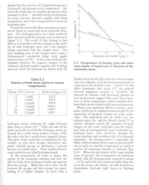

No you're overlooking the fact that the density of fresh water is less than the density of sea water. It turns out to be important, for shelf ice at least.
If a floating body of ice has mass m we can do some simple calculations to consider the implications to sea level if it melts.
These relations are trivial and yet hidden within them is the truth.
m=\rho_{ice}V_{ice}
Upon melting to fresh water the mass remains the same.
m=\rho_{freshwater}V_{freshwater}
By Archimedes' principle, the weight of the ice is equal to the weight of the displaced sea water.
mg=\rho_{seawater}V_{displaced seawater}g
Divide by g.
m=\rho_{seawater}V_{displaced seawater}
Bring together the fresh water and seawater terms.
m=\rho_{freshwater}V_{freshwater}=\rho_{seawater}V_{displaced seawater}
Rearrange:
V_{freshwater}=\frac{\rho_{seawater}}{\rho_{freshwater}}V_{displaced seawater}
If seawater is 5% denser than freshwater then.
V_{freshwater}=1.05V_{displaced seawater}
Sea level is related to the volume of water in the basin such that the greater the volume of water in the basin the greater the sea level.
V_{filledbasin}(beforemelting) = datum + V_{displaced sea water}
V_{filledbasin} (aftermelting) = datum + V_{fresh water}
V_{filledbasin} (aftermelting) = datum + 1.05 * V_{displaced sea water}
Therefore:
V_{filledbasin} (beforemelting) < V_{filledbasin} (aftermelting)

I agree that 1 kg of fresh water occupies a larger volume than 1 kg salt water, other things being equal. The issue is whether the ocean level rises when floating ice melts. When fresh water ice enters the ocean, it will raise the ocean level immediately by displacing whatever volume based on its density. If liquid fresh water enters the ocean, it would "float" because it is less dense and raise the ocean level. So, as far as I can tell, there is no difference between a given amount of floating fresh water ice melting in the ocean and an equivalent amount of fresh water entering the ocean in liquid form. That's the point I was making.
EDIT: I did find some articles that agree with you, but they don't appear to be from peer reviewed journals. On one hand, it seems that as a large mass of floating fresh water ice melts, the released fresh water would occupy a larger volume than the salt water mass it displaces. In part, this would be compensated by the decreased volume of salt water displacement by the melting ice mass. In any case, how long does the melt water remain "fresh"? It seems that the fresh melt water would quickly lose its characteristics as it is dispersed in the much larger volume of salt water. The salinity of the oceans is maintained by a balance between evaporation and fresh water infusions.
Could you find a peer reviewed article that supports your argument?

It won't "float" in the sense of the ice, which clearly has some of it's head above the water. The fresh water will redefine sea level. When it is ice it redefines sea level by displacing saline sea water; when it melts it redefines sea level using its own fresh water. < That's the key.
I fully acknowledge that it is a small effect. But it is one that is almost always overlooked. It can safely be overlooked when we consider sea ice because sea ice is derived from the ocean itself and melts and forms every year, it cannot be safely overlooked for shelf ice which is the floating portion of the continental ice sheets. The point is that the melting of the shelf ice will act to slightly increase sea level by the effect I have described, it is not a zero contribution as is often assumed.
Haven't looked. But the point is that it is widely ignored, which is why I bring it up. I would be interested to see if someone here can debunk it.

To put it into perspective consider the sea level, z in relation to the volume of the basin, V and the area, A of the basin V=Az.
V_{new}=V_{old}+\Delta V
Az_{new}=Az_{old}+\Delta V
Change in sea level is denoted \Delta z
\Delta z=z_{new}-z_{old}=\Delta V/A
\Delta z=(V_{freshwater}-V_{displaced seawater})/A
If for example V_{freshwater}=1.05V_{displacedseawater}, then
\Delta z=0.05V_{displaced seawater}/A
and V_{displaced seawater}=\frac{\rho_{ice}}{\rho_{seawater}}V_{ice}\approx0.9V_{ice}
\Delta z=0.045V_{ice}/A
So for example with these numbers a 1000 km3 volume of ice melting in a 100 million km2 expanse of ocean basin will contribute about .45mm of sea level rise. Not much but I would not call this negligible.

Two equal masses of liquids of different composition and therefore density occupy different volumes.
Therefore any attempt to assess the change in world ocean volume due to melting icecaps must take into account, or show to be negligeable, the change in composition due to the dilution of saline water by meltwater.
If you add salt to water the volume doesn't change significantly. This is because salt is soluble in water.
At the risk of repeating myself, all I am saying is that when ice melts it turns into fresh water. The addition of this fresh water to the sea does more to increase the sea level than would the insertion of the ice into the sea. The maths is all there and I have made it very easy to follow for anybody interested in taking apart the logic.
What I think you are saying is that I have made an erroneous assumption in saying that the addition of the fresh water will increase the volume of the sea by exactly the volume of the fresh water. Instead the fresh water will take in some salt from the sea, and therefore it will become more dense. Up to here I would agree, but the next point I think is where we disagree.
You seem to argue that because the density of this water increases the volume must decrease to accommodate this increase in density. However, that is wrong because the increase in mass (by the influx of salt) is what causes the density to increase, the volume stays pretty much the same. I argue that the transfer of salt from one water body to the other makes no difference to the volume of the water, and therefore that this point is moot, and all my previous arguments stand unaffected.
This is my reading of your argument, I hope that I have made it clear enough for you to tell me where exactly I am wrong.
1) I have never stated that the volumes are additive. To do so would be to promote a falsehood.
2) I have stated (repeatedly) that the density of salt water is greater than that of fresh water.
3) That if you mix some salt water with some fresh water the resultant liquid will have a density intermediate between the two.
4) The the volume of the mixture will be equal to the mass of the mixture divided by its density.
Which of these statements do you disagree with?
So if you have a 1 litre of salt water, and 1 litre of fresh water, put them together and shake them up, how much water do you have?
The answer may not be exactly 2 litres, but in my calculations I have assumed that it will be. Please can you clarify for me that this is your objection. If not what is your objection?
(If yes: How important is this effect? Anyone)
