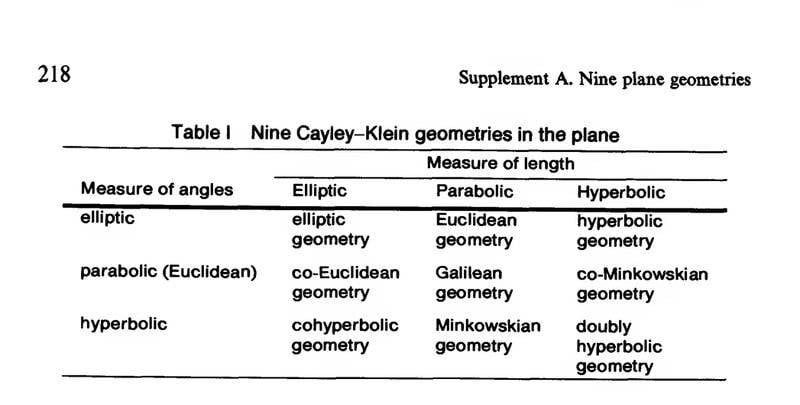

Histspec said:
When people refer to spacetime as hyperbolic, they usually mean that parts of spacetime can be described by certain models of hyperbolic space. For instance, relativistic velocity space
They shouldn’t refer to Minkowski spacetime as hyperbolic since they probably don’t refer to Euclidean space as circular or spherical or elliptic… for instance, the space of directions…
Minkowski spacetime is flat (zero Riemann tensor) but uses hyperbolic trigonometry,
just like Euclidean space is flat (zero Riemann tensor) but uses circular trigonometry.
Euclidean, Minkowski, and Galilean are zero Riemann curvature spaces… and are the affine Cayley-Klein geometries, where the parallel postulate applies. That’s why we can do vector algebra on these spaces.
From Yaglom’s “A simple noneuclidean geometry and its physical basis: an elementary account of Galilean geometry and the Galilean principle of relativity”
The last two rows are spacetime geometries.
The last row has a Lorentzian signature…
(1+1) deSitter, Minkowski, and anti-deSitter.
