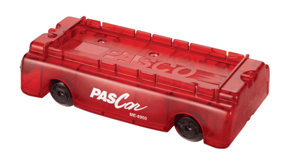

The vehicle has a spring built in. In the image you can see the button on the left side that launches the car when pressed. I am not sure if it is front or rear wheel drive.

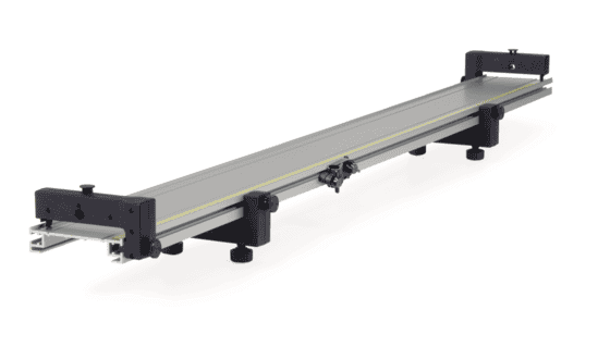

and the track looks like this

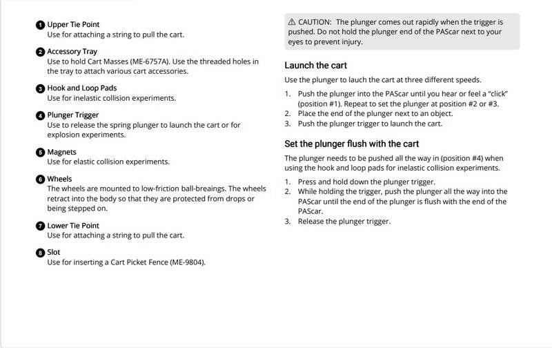

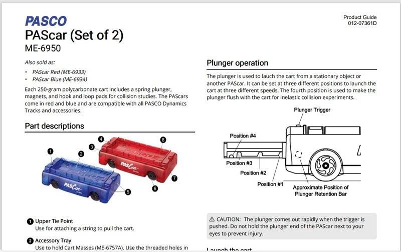

This car does not have any driving wheels.
It is pushed forward by a built-in plunge.
I see no reason for obtaining different results due to weight distribution.
It is important that you select the same position of the plunge for each try, as well as that you measure the location, speed, etc. of the same point on the car.
I also see the manipulation of the plunge trigger button as a potential source of errors in the measurements.
Please, see:
https://www.pasco.com/products/lab-apparatus/mechanics/carts-and-tracks/me-6950
