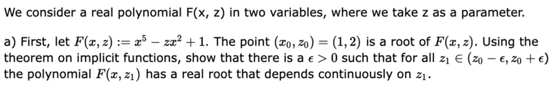

Hi,
I'm not sure if I've solved the problem correctly
Text of a math problem: a real polynomial F(x, z) in two variables with z as a parameter; part a) gives F(x, z) = x^5 - zx^2 + 1, the point (x0, z0) = (1, 2) as a root, and asks to show via the implicit function theorem a neighbourhood of z0 where F(x, z1) has a continuously dependent real root.
In order for the Implicit function theorem to be applied, the following two properties must hold ##F(x_0,z_0)=0## and ##\frac{\partial F(x_0,z_0)}{\partial z} \neq 0##. ##(x_0,z_0)=(1,2)## is a zero and ##\frac{\partial F(x_0,z_0)}{\partial z} =-x^2=-1## so both properties are fulfilled
According to the Implicit function theorem, there now exists a function ##g## for which the following relation ##x=g(z_1)## is valid in the neighborhood ##(z_0 - \epsilon, z_0 + \epsilon)##.
Then the following applies ##F(x,z_1)=F(g(z_1),z_1)##
You're doing good! keep going. You could end up with a value of some ##\epsilon>0## in the end, because that's the the problem is asking for. Then, you could show that the statement in the problem is true using the value of ##\epsilon## you found and the implicit function theorem.
