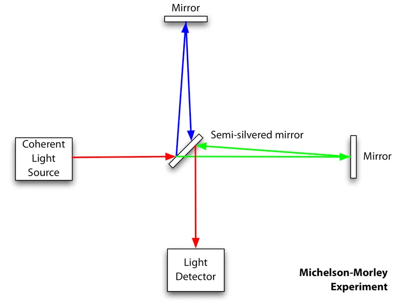

This is the Michelson-Morley interferometery I know of. Is it one source or two sources?
qnach said:
This is the Mach-Zender interferometer I know of. Is it one source or two sources?
Both of them have one source, which gets split by a beam splitter into two beams. Just as I described in post #4.

qnach said:
OK Stern-Glash is not (Sorry I am very confused). It is not even an interferometry. But how about Michelson-Morley and Mach-Zehnder?
Michelson interferometers, Mach-Zehnder interferometers (and also the double slit) measure field correlations. The quantity you measure in the end is of course an intensity (because this is how detectors work), but you delay or offset one field in space or time and quantify the correlation between the fields. Loosely speaking, the information you get is: If I know the value of my field at some time and some position, how well can I predict the value of the field at a temporal delay t' and a position offset x'. This is entirely classical information and cannot be used to identify nonclassical states.
In HBT, the question you ask is: If I detect one photon from my light field at one detector, what is the normalized probability to detect another photon at the other detector? This information may tell you something about whether a state is nonclassical. Take for example the simple example of a single-photon state. If the photon gets detected at the first detector, it is gone and you will never find a simultaneous detection at the second detector. A Michelson interferometer cannot give you that kind of information.
