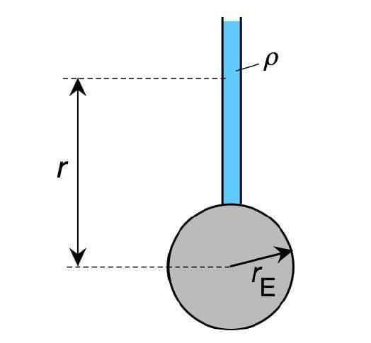

Diagram of a tall vertical tube of liquid of density ρ rising from a grey sphere of radius r_E, with a dashed horizontal line at the surface and a double arrow labelled r measuring the height from the sphere's centre to the liquid surface.
There is an infnite high hydrostatic head in an infite high tank on the surface of earth. How big is the pressure p(r) in tank at a distance r. Ignore the rotation of the Earth and assume the water stays liquid. ( So basically ignore it's an impossible scenario )
Instruction: Look at a mass element with thickness dr and establish the condition of equilibrium between gravitational force and pressure force. You'll get a differential equation. Then use the fact that ##p(r \rightarrow \infty )## is 0.
Try to give an answer without G and M. G is the gravitational constant and M the mass of the earth
Given:
##g,r,r_E,\rho,M## M is the mass of the earth
##G*\frac{M*m}{r^2}=F_g##
[/B]
I'don't fully understand how set up the equillibrium condition.
So the Earth is pulling the water:
##G*\frac{M*m}{(r)^2}=m*g##
but the water dr away pulls the water in the opposite direction but is also pulled towards the earth. I don't see it.

The liquid is in equilibrium. Write the force balance equation for a thin layer of thickness dr.

##-G*\frac{M*(\rho*A*dr)}{r^2}=A*p(r)-A*p(r+dr)##
##-G*\frac{M*(\rho*A)}{r^2}=\frac{A*p(r)-A*p(r+dr)}{dr}##
The right side would be a perfect differential equation. Does this work?

The equation is almost correct, (check the signs), but one side of an equation is not an equation. Have you meant perfect differential? (Better, it is negative of the derivative of p with respect r) If so, what is the function p(r)?

##p(r)=\rho*g(r-r_E)##
No.
Divide the whole equation by A.Then the numerator on the right side is -(p(r+dr)-p(r))= -dp, so the right side is -dp/dr. Look at the left side. dp/dr=?
= ##-G*\frac{M*(\rho*dr)}{r^2}=p(r)-p(r+dr)##
= ##-G*\frac{M*(\rho)}{r^2}=\frac{p(r)-p(r+dr)}{dr}##
= ##G*\frac{M*(\rho)}{r^2}=\frac{dp(r)}{dr}##
= ##G*\frac{M*(\rho)}{r^2}*dr=dp(r)##
integrate from r_E to infinity, with infinity = 0
##-G*\frac{M*(\rho)}{r^2}*r_E=p(r)##

The function p(r) is asked, not the pressure at r_E.
dp/dr =constant/r2. What is the antiderivative of the function constant/r2?
Or: add integral symbols to both sides. Integrate the left side from r to infinity, the right side from p to zero:
##\int_r^∞\ {G*\frac{M*(\rho)}{r^2}dr}=\int_p^0 dp ##
Note that there is a sign error.

##-G*\frac{M*(\rho)}{r}+C(maybe?)=p(r)##
This is OK, but the minus sign. See the original equation, with the forces. The water column above the layer pushes it downward, just like gravity, that pulls it downward. The hydrostatic pressure below the layer pushes it upward. Choose C so as p(∞)=0.
##G*\frac{M*(\rho)}{r}+C=p(r)##
##p(r=\infty)=0 =C##
how do I make G and M disappear now?

You know that the gravitational acceleration is g at the surface of the Earth, when r=RE. What is the gravitational acceleration at RE, expressed with G, M and RE?
##G=g*r_E^2/M##
## p(r)=\frac{\rho*g*r_E^2}{r} ##
Thank you very much
