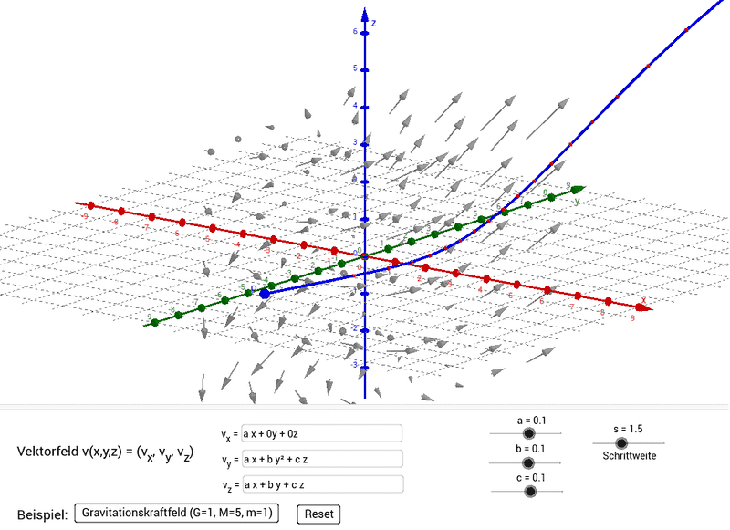

https://www.geogebra.org/m/M9SEYXSy
Do arbitrary paths through this vector field deserve the name solution or only the unique blue one, which required a deliberate choice? That's a discussion for a Wittgenstein seminar, not a matter of mathematics. The word integral refers to a solution and it serves its purpose. Nobody would benefit from a distinction here other than in the adjective. It still distinguishes all routes through this field, which do not follow a flow.
