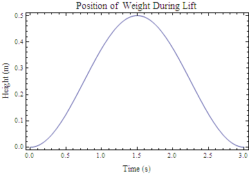

Here's a very simplified analysis of what's going on, but it will work to explain the concept without the use of calculus. Let's assume we're comparing 2 sets using the same weight, but different rep speeds. set 1 uses 0.5/0.5 and set 2 uses 2/4. For simplicity's sake we'll assume the weight accelerates 100% of the way up and down for both sets.
Known: Mass(m) =100kg (220lbs) Acceleration(a)=?? Distance(d)=1m
First let's solve for the acceleration required to move the weight 1m in the time frames of the sets.
Calculate a, to travel 1m in 0.5s (Raising and Lowering of set 1):
d=1/2at^2
1m=1/2*a*(0.5s)^2
a=2(1m)/(.25s^2)
a=8 m/s^2
Calculate a, to travel 1m in 2s (Raising set 2):
d=1/2at^2
1m=1/2*a*(2s)^2
a=2(1m)/(4s^2)
a=0.5 m/s^2
Calculate a, to travel 1m in 4s (Lowering set 2):
d=1/2at^2
1m=1/2*a*(4s)^2
a=2(1m)/(16s^2)
a=.125 m/s^2
Now let’s solve for the forces required to accelerate the weight
Calculate the force required to raise 100kg, 1m, in 0.5s:
Sum of forces=ma
F1-mg=ma
F1-(100kg)(9.81m/s^2)=(100kg)(8m/s^2)
F1=(981+800) kg m/s^2
F1=1781 kg m/s^2 required to raise the weight 1m in 0.5s
Now compare it to the force required to raise 100kg, 1m, in 2s
Sum of forces=ma
F2-mg=ma
F2-(100kg)(9.81m/s^2)=(100kg)(0.5m/s^2)
F2=(981+50) kg m/s^2
F2=1031 kg m/s^2 required to raise the weight 1m in 2s.
So does it mean that the forces needed to raise a weight 1m in 2 seconds = 1031 and to raise the weight in .5 of a second = 1781 ?
Wayne

The forces "can be worked out" only if you know what kind of forces you're looking for.
In physics there're two values of forces.The average and the momentary value at each specific instant of time.The first is the weight in both cases of your example and for the second we need more data.
Wayne
The assumption is wrong hence the calculations are wrong too.You start and end at rest so you don't accelerate for 100%.Every acceleration is accompanied by a deceleration of equal magnitude.The average acceleration is zero.

  • #133
Wayne (yet again)
I have looked at some of your last comments and I think I am getting to understand your problem. I should have got a clue from the extreme length of your posts. Your problem is that you don't actually know what question to ask so you just relate case after case of what you have experienced, in great detail, and want someone to make up a suitable question and then answer it for you.
I think that you may, in fact, have begun to accept that the mean force on an object, that starts and ends stationary, is just its weight. Good.
You still seem to think that there is a definite answer about Maximum force, related to rate of lifting. But you haven't accepted that it depends solely on the dynamics of what your muscles happen to be doing. It will depend on Energy / Food supply to the cells and all sorts of other chemical matters that Mechanics (which is the bit of Physics you are invoking) can discuss. There are many different combinations of force and time that can take your weight up to the top. A good lifter will make the best of what he's got and have found some sort of optimum.
