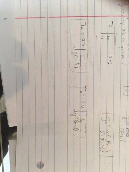

Okay - how does this look?
You are still using the wrong formula for the gravitational attraction when inside the sphere.
Here's a clue. Inside a unform spherical shell, the shell exerts no gravitational field. So at distance r<Re, what part of the Earth is responsible for the gravitational field? What is the mass of that part? What is the resulting gravitational acceleration?

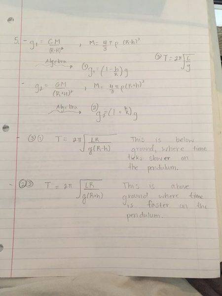

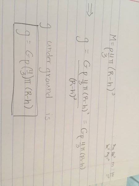

This is the resulting gravitational acceleration.

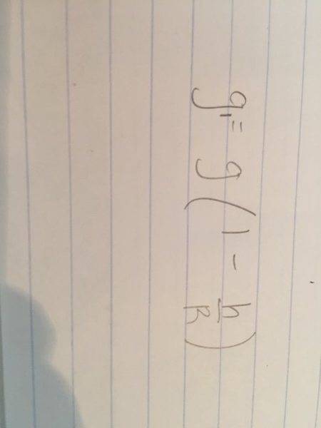

I believe this is how it changes when you are underground. the g without the subscript is Earth's (9.8 m/s2)
If ##h## is the distance from the surface to the particle, then yes.

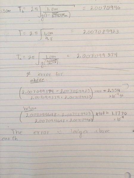

I used percent error and found that it was greater for the pendulum above earth.

Vitani11 said:
Method
It's difficult to see what you've done there. To help you with latex, you are looking for something like:
##g_a(h) = g(1 \pm f_a(\frac{h}{R}))##
##g_b(h) = g(1 \pm f_b(\frac{h}{R}))##
Where ##g_a(h)## is the gravity a height ##h## above the Earth and ##g_b(h)## is the gravity a depth ##h## below the Earth's surface. ##f_a## and ##f_b## are functions you need to find and compare. ##R## is the radius of the Earth.

Okay, but why is it plus or minus? I know below is the expression with a minus sign, and I've gotten those results but I figured that since for above ground the mass isn't changing, then the expression for how gravity changes would just be the typical ga = GM/(R+h)2 divided by g = GM/R2. Either way, I've tried it both ways and am getting that the error is larger above Earth but with different percent errors for each function. I've been using h = 30m to compare.
That may be correct for ##h = 30m##, but what about other values of ##h##.
It was ##\pm## so I didn't give too much away! Did you get a formula for gravity a distance ##h## above ground, compared to surface gravity?

Yes that is what I did. In my most previous post with pictures you can see the equations I used although I know it's hard to read. I'll try other values for h. Thanks for the help - I think I am in the home stretch, lol.

##g_b(h) = g(1 - \frac{h}{R})##
That's your equation for gravity below ground, which is correct, using latex.
The above ground is harder. Do you know about binomial expansions for negative powers?
