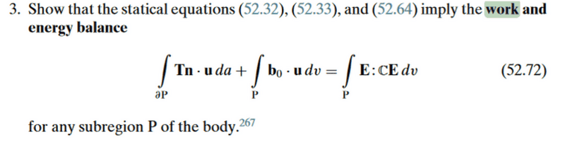

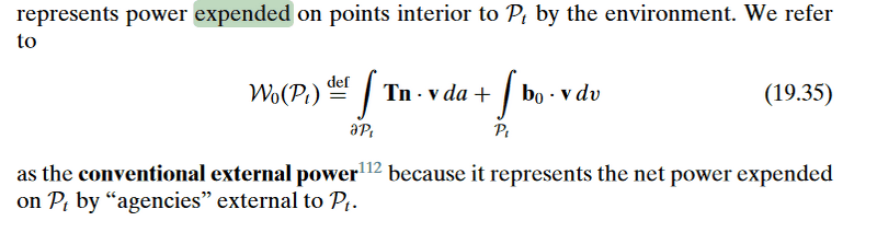

Does your textbook, which describes the definition of W and P, postulate stationary T and b ?
It does not, they just define it that way.
The latter refers the three statistical equations so it seems not a general relation.
I just couldn't find an explicit mention of work in the textbook (its always power), but its still the same definition found in other places, such as:
https://en.wikipedia.org/wiki/Virtu..._of_virtual_work_and_the_equilibrium_equation
We start by looking at the total work done by surface traction on the body going through the specified deformation:
{\displaystyle \int _{S}\mathbf {u} \cdot \mathbf {T} dS=\int _{S}\mathbf {u} \cdot {\boldsymbol {\sigma }}\cdot \mathbf {n} dS}
i know the text talks about virtual work, but this excerpt specifically deals with regular work.
