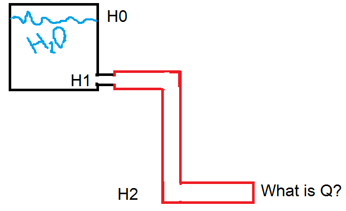

I'm building an experimental set-up for some heat exchanger I'm trying to analyze, I want to maximize the flow through this little piece.
I have a stable temperature bath, (see picture) that has an evacuation valve on the bottom.
I only took introduction to Fluid Dynamics (found it amazing BTW). Anyways, I have a question as I always found this topics to be counter-intuitive and I just wanted to make sure.
If you look at the picture, and assuming some derived equations from Bernoulli's principle:
Volumetric flow rate is constant (right?)
Volumetric flow rate = velocity * Area of pipe
Velocity = Sqrt (2 * g * h)
My question is, on the drawing, the red pipe, does it help increase the flow rate or not?
Here's my line of reasoning:
- I would assume it DOES NOT, as the flow rate is limited by the orifice in which the water enters the piping system, so the max. flow rate I could ever get from this is the difference of H1 and H0 x the diameter of that orifice.
However, if say I took a point at H2 and tried to find out the velocity, in theory using the same equation I should have a higher velocity (differenc between H2 and H0) and therefore a higher flow rate? (this doesn't make sense in my opinion)
I just wanted some clarification on how to apply Bernoulli's principle in this particular case. As mentioned earlier I want to maximize the flow but I don't really know how to without using a submersible pump or something of the sort.NOTE: (There is a pump at the end that brings everything back to the top, so H0 remains constant)

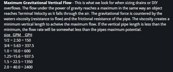

On another similar project I found the following chart that specifies the minimum vertical pipe diameters for gravity fed water flow without flowing pressure losses that may be of benefit to you.

You still have fluid in the pipe, which does increase the pressure, which can in turn, potentially, increase the fluid flow. You WILL get higher static pressure on the bottom using the H0-H2, because it is contained inside the tube, instead of being depressurized to the environment (as it would be at H1).

With the tube attached, you will get higher flow rate because the pressure at the entrance to the tube will drop below atmospheric. Just call this pressure pb, and apply Bernoulli to (a) the tank between the upper surface and the oriface and (b) the tube between the oriface and the exit. The deficit in fluid pressure at the entrance to the tube will just be equal to the static head of fluid in the tube (since there is no velocity change in the tube).

Thank you for the correction to my error. I should have realized the potential of the gravity effect between H1 and H2 to create a lower than atmospheric discharge pressure for the orifice.
