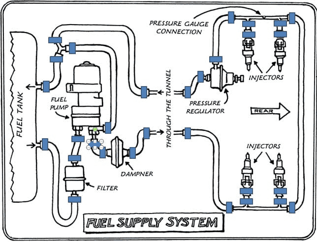

Just curious (and sorry if too far off-topic), but why would there be a fuel return line from an engine? Is that common in industrial diesel engines?
Yes, this is common. The idea is to measure the fuel consumption by subtracting the return fuel flow rate from the supply fuel flow rate, in order to monitor the fuel consumption in general.
Interesting. Why does some of the fuel bypass combustion?
Sorry, but I'm not sure I understand your question.
berkeman:
In most modern fuel systems, the fuel pump is shunt-regulated. A pressure regulator at the fuel rail 'returns' whatever fuel is required to maintain the required pressure. The capacity of the pump (at least) slightly exceeds the maximum required fuel flow - there is always some 'dumped' fuel. A 'constant' fuel pressure makes fuel injectors a lot easier to implement.

Returning fuel to the tank also warms the fuel up. This helps prevent the fuel from gelling up in cold weather. One downside is the fuel filter(s) likely need to be serviced more often, but of course the upside is that the tank stays cleaner.
If I'm not mistaken, fuel is now typically taken off of the very bottom of the tank so everything including water is drawn into the fuel system and taken care of. When the water in fuel indicator comes on you can be sure that the last place you filled the tank was the source of the water. Nothing foreign sloshes around on the bottom of the tank very long.
I'll do a little digging later to provide a link to a fairly good training video for the 7.3 litre international fuel system on the diesels used in Ford pickup trucks. Later engines are very similar.
Air in the fuel system is self-bleeding if the top of the injection pump inlet reservoir, mechanical fuel injectors, and the ullage at the top of the fuel filter, are connected through a line back to the fuel tank.
The piston clearance in a mechanical fuel injector allows some bleed of fuel into the spring chamber, that will eventually block the injection action, if not vented through the return line to the tank.
