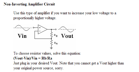

I want to build own circuit usinghttps://ez.analog.com/external-link.jspa?url=http%3A%2F%2Fwww.kynix.com%2FProduct%2FCate%2F470.htmland resistors. I have 12V power source (car accumulator) and 6V input voltage (Vin). I want to get 12V Vout and 25W at the output. So that is about 2A current(25/12=2).
I heart that operational amplifiers (OA) work only in low currents. Therefore I am not sure that it is appropriate to use OA to implement my aim.
My aim is to get 12V voltage and 25W power at the ouput from input voltage Vin=6V and 12V power source(car accumulator) using following circuit.
Non-inverting amplifier circuit diagram with an op-amp, input Vin on the left, output Vout on the right, and feedback resistors Rb and Ra forming a divider to ground.
So is this appropriate circuit? If, no can someone provide alternative curuits? Thanks!

ok so a 12V car battery
What is this 6V in you are talking about ? 6V into what ?
so why are you not just taking the 12V from the battery directly ?
what are you wanting to power ?
You cannot get more power out of something than what you put into it... in fact there will ALWAYS be less power out due to various losses
Reread the last sentence in the graphic you posted
you really need to read up on OP-Amps and how they work
