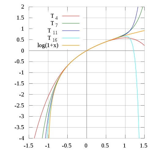

Wikipedia said:
The Taylor polynomials for log(1+x) only provide accurate approximations in the range −1 < x ≤ 1. Note that, for x > 1, the Taylor polynomials of higher degree are worse approximations.
Disappointing, right? Apparently, Taylor can't save use in all cases after all...
Well, it can :smile: You just need to work in another base point. If you need to find Taylor approximations around 3, then you'd just have to use log(3+x).
Or, if that doesn't work, you can always use properties of logarithms to give you the correct answers:
For example, log(8)=3log(2) and log(2) has a good approximation.
Or, log(105)=log(10511.(1/11))=11log(1051/11) and this logarithm has a good approximation.
Isn't math cool? :biggrin:
