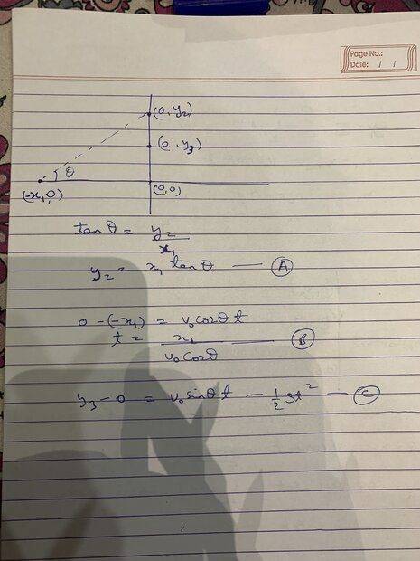

Doc Al said:
That's how far it falls. But where did it start from? What is the can's initial position?
Origin
rudransh verma said:
Origin
Nope. The ball started at the bottom (ground) level, but the can did not. What's the initial height of the can above the ground level?
I took the starting point of can as origin
You are finding the position above ground level for both, so measure everything from ground level.
@Doc Al Now what?
Again, it's a bit difficult to understand what you've written. Please type out your equations here, not handwritten on paper.
(A) Start here: In terms of the horizontal distance traveled (I'd call it "d") and the angle of the ball's initial velocity (θ) express the initial height of the can.
(B) Solve for the travel time for the shot to cover that horizontal distance. (In terms of those variables.)
(C) Write an expression for the height of the ball at that time. (Measured from ground level.)
(D) Write an expression for the height of the can at that time. (Measured from ground level -- that's where the initial height of the can is needed.)
Compare!

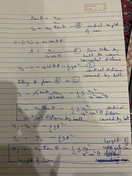

I have written 3. I don’t understand how to write 4th
@berkeman help!

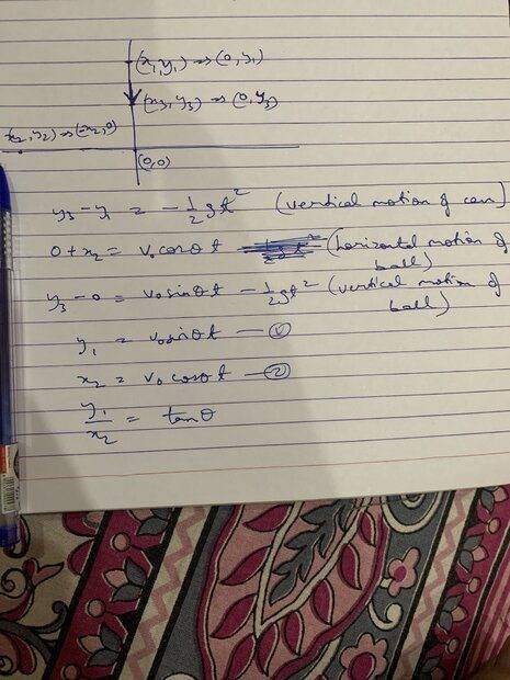

@berkeman help!
So far, so good. For (C) you wrote the height as a function of time -- now plug in the time, which you found in step (B).
For (D), use the same approach but realize that you aren't starting from y = 0, but y = y2 (which you found in step (A)).
For (D), use the most general form of the kinematic equation:
y = y0 + v0,y t + (1/2) a t2
You know y0; you found that in (A). You know the initial velocity of the can. And you know the acceleration due to gravity.
y3 in first box is vertical distance covered by ball whereas y3 in second box is the height of can after time t. For first y3 I took starting point as 0. For second y3 I took starting point as y2 and applied y3-y2= -1/2gt^2
But is it right to take final point as y3 and initial as y2 because y2>y3. Isn’t this negative displacement?
Good. Rearrange this to give the position of the can at time t: y3 = y2 -1/2gt^2
The can is falling, after all. So its displacement from the starting point is negative. So what?
Now find its position at the time you calculated in step (B). And compare that position to that of the ball, which you should have done for step (C).
Already done it. It’s shown in image above in the boxes. Both y3s at time t are same.
So at the same time t both the y3 are same. This means position of the can and ball are same after time t from below and above. If both y3 had different values they would not have hit each other.
Excellent.
