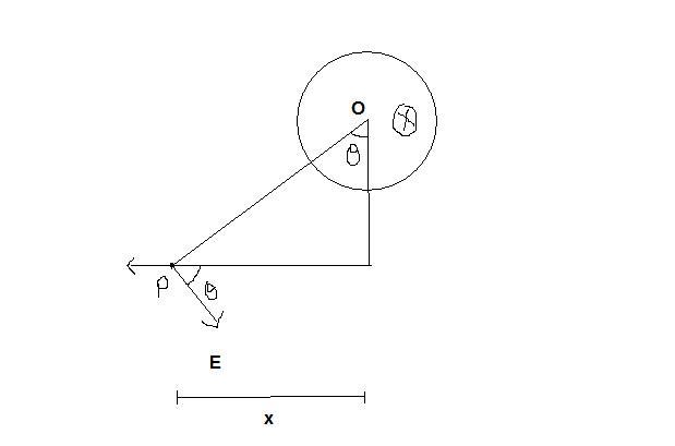

In a cylindrical region of radius R, there exists a time varying magnetic field B such that dB/dt=k(>0) . A charged particle having charge q is placed at the point P at a distance d (> R) from its centre O. Now, the particle is moved in the direction perpendicular to OP (see figure) by an external agent upto infinity so that there is no gain in kinetic energy of the charged particle. Show that the work done by the external agent is independent of d and find it.
Let the angle between the line joining the particle to the point O make an angle θ with the vertical.
E.dl=-kπR2
E*x*cos(180-θ)=-kπR2, where x is horizontal distance of the particle from the initial position.
Substituting x for dtanθ and solving, I get W= qkπR2 which is incorrect.
The answer given is qkπR2/4

What's your calculated E? How come I see no integration over cycle when you are clearly using Maxwell's Law? That's a blatant error,sorry.
E=kπR2/xcosθ
Which integration are you talking about?
Ambiguous since Maxwell's Law is to be applied only to fixed mathematical loops.
Anyways since the angle force vector makes with the displacement is varying you will have to integrate to get the work.

As aim1732 has suggested, you're not evaluating the LHS correctly. You can use Faraday's law to calculate E as a function of the displacement r. Once you have that, you can then find the force on the charge as a function of the displacement r and integrate it to find the work done.

At any instant, let the particle be at P distant 'x' from the initial point. E at that point has the direction as shown.
dl vector is directed along the path traveled by the particle. I just used the dot product of two vectors.

Faraday's Law says
[tex]\oint_{\partial S} \mathbf{E}\cdot d\mathbf{l} = -\frac{\partial \Phi_{B,S}}{\partial t}[/tex]
where S is a surface and ∂S is the closed boundary of that surface. The expression -kπR2 is equal to the rate of change of flux, but your calculation of the line integral is wrong. The path the particle travels has nothing to do with the boundary of S.

First separately derive the electric field at a distance r from the centre of vortex. Then write out the differential work in terms of r and angle b/w displacement and force. Eliminate angle and integrate under proper limits..
By the way the existence of a vortex has absolutely nothing to do with the whether there is a charged particle at that point or not.
