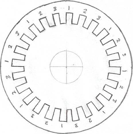

Well, now that i understand how to calculate the induced voltages in the stator, I am having a problem understanding how to position the magnets correctly. I am going to use 12 magnets (6 pole pairs), by dividing 360 degrees by 12 magnets i get 30 degrees for each magnet. Using the stator diagram as reference, 30 degrees for each magnet, the magnet covers one side of each coil in all three phases, is that the correct placement? any insight would be appreciated
