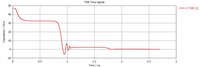

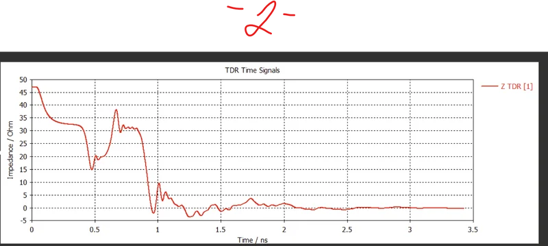

Hello , As you can see in the simulation when we have a short load we have 0 impedance in the end because its 0 ohms.
On the other hand as you can see below in the simulation when we have inductive load then we have negative bump in the tdr.
A shorting via can ve viewed as inductor because its a straight line .
Why in our EM simulation I dont have negative bump as in the LTspice simulation?
Thanks.

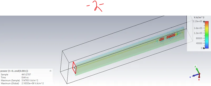

Hello Baluncore, Sorry yes I understand.

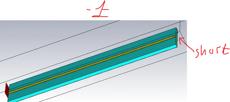

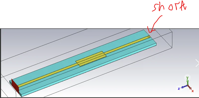

As you can see I simplified the model into one microstrip line with short at the end .
From the power flow simulation the signal reaches the short at 0.44ns.
few questions:
1.As you can see in the CST TDR when the signal comes back from the short at around 1ns It creates small ripples at 1ns.why is it happening?

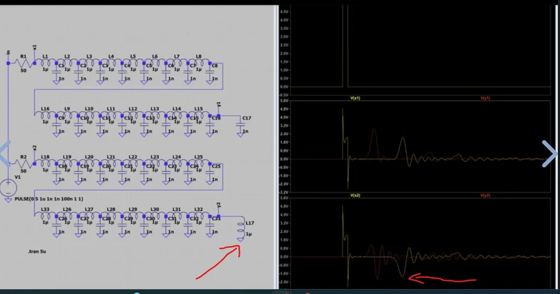

4.I have made a LTspice simulation as shown in the photos below and in the attached files.
What is the intuition behind the shape of this inductive peak? why the echo from this kind of load is such a peak?
Thanks.

yefj said:
1.As you can see in the CST TDR when the signal comes back from the short at around 1ns It creates small ripples at 1ns. why is it happening?
Your via is an inductor, but if you have not trimmed the track where the via is located, it makes a small parallel plate capacitor in parallel with the inductive via. I believe the TDR step is ringing the resonance of that tank circuit.
I believe the bandwidth is too low because your pulse rise time is 100ns. For such a short line I would use 1ns rise and fall times.
Current in an inductor cannot change instantly.
V = L * di/dt ; so, di/dt = V/L.
An inductor therefor looks at first to the step voltage, like an open circuit. Then at the end of the TDR trace, there remains only the low series resistance of the inductor.

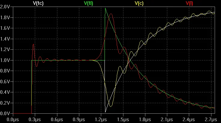

Here I compare lumped lines with TLINE in LTspice.
I adjusted your lumped lines to have Zo = 50 ohms. I halved the end component lumps, which removed echos due to line mismatch.
The green trace shows a wideband line with an inductive termination.
The white trace shows a wideband line with a capacitive termination.
The red trace shows a lumped line with an inductive termination.
The yellow trace shows a lumped line with a capacitive termination.
All the ringing is Gibbs effect, due to the narrow bandwidth of the lumped lines when compared with the spectrum of the voltage step.
Hello Baluncore,Gibbs effect if I understand correctly is saying that when our bandwidth is limited in the transmission line then harmonic data gets filtered thus given us ripples(sinusoidal data).

1 .Suppose I dont want to change the line in LTspice.how can you reccommend to recreate this BW issue , how can I make the pulse BW higher then the BW of the line element in LTspice?
The LTspice TLINE model has infinite BW, if that is what it needs. It effectively has a BW decided by the time step of the LTspice simulation. You can indirectly increase the BW by specifying very short rise times on the pulse generator.
To lower the BW of a TLINE, you insert a low-pass filter into the signal path, before or after the TLINE. You will then have a BW limited line.
To see the Gibbs effect, the LP filter must cut off the high frequencies, faster than the harmonics of the voltage step fall off. You should be able to simulate that with LTspice.
