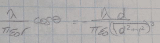

Field due to infinite wire: E=λ/2πε0r*cosθ
E = σ / ε0
Et = - (Eimage+ Ewiire)
Et = - λ/πε0r*cosθ
r=√(d2+y2)
cosθ = d/√(d2+y2)
σ = λ/πr3/2
https://drive.google.com/file/d/0B76TBRMyBuffYzdZYUpVUk8zdkU/view?usp=sharing I only really need help with part g) I'm obviously doing something wrong as I either get 0 or an indefinite... Not quite sure what I"m doing wrong.
Handwritten equation on grid paper: λ/(πε₀r) cosθ = −λd/(πε₀(d²+y²)^3).
The power of 3 on the right side is incorrect.
