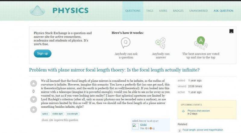

Screenshot of the Physics Stack Exchange question page titled "Problem with plane mirror focal length theory: Is the focal length actually infinite?" with the question text and tags optics, visible-light, wavelength.

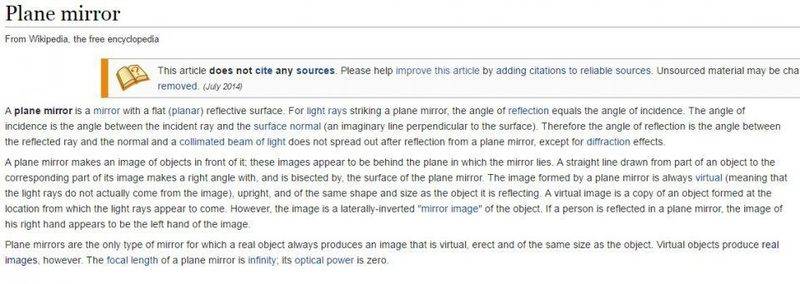

Screenshot of the Wikipedia article 'Plane mirror' with an orange 'does not cite any sources' notice above several paragraphs of body text describing reflection and virtual images.

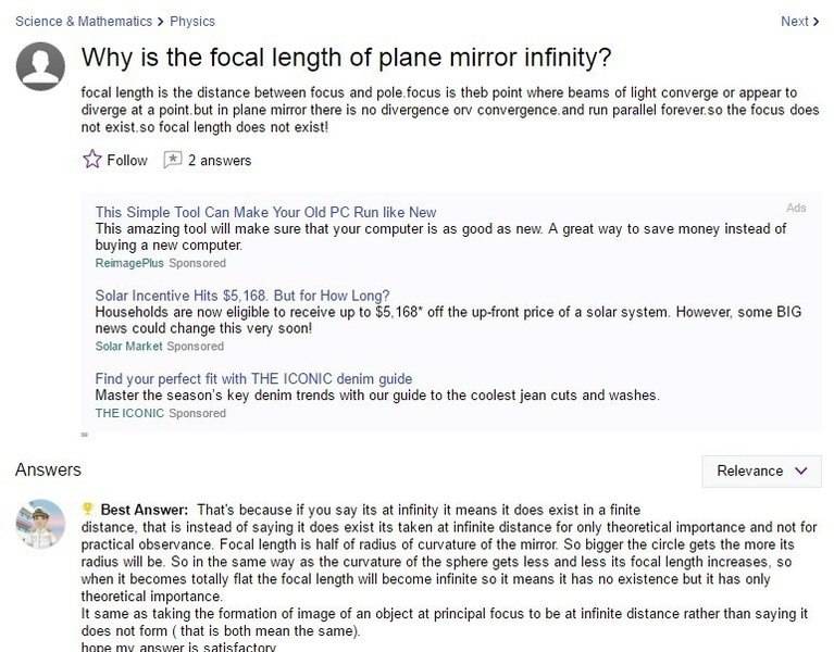

Screenshot of a Physics Forums page titled 'Why is the focal length of plane mirror infinity?' with the question text, a follow button, and a 'Best Answer' reply below advertisements.
