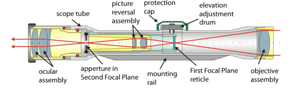

In order for a conventional telescopic riflescope to function, it must invert the image two times.
As a result, the light-rays traveling through the tube must meet at two focal points.
With my limited knowledge of optics, i assume that parallell light going in through the objective will meet at a focal point (or two in this case).
As an example, if you point the scope at the sun, it should collect light at the focal points; And you could theoretically set something on fire by placing it at the focal point. (Please correct me if I am wrong!)
So the way I see it, if you place even the smallest reticle in this focal point, it will block most of the light of an image coming in. Also the size of the reticle should be magnified greatly.
Obviously I have misunderstood something. But what?
Also, why do they call it a "Focal Plane", and not a focal point?
Only light coming in precisely parallel to the scope will land on the focal point. Light arriving from slightly off axis will land at an offset from the focal point.
Because it is where the image of an object at infinity will form. Every point on the plane corresponds to an angle of incidence. More generally, for an object not at infinity, every point on the plane corresponds to a point on the object being viewed.

Shadow89 said:
I guess the lines in the picture are purely representational then.
There can be a whole family of lines from points on the object to different places on the focal plane. The reticle only blocks out parts of the image that it lays over.
The reticle has to be in the same plane as the intermediate image so that the eyepiece produces the image of the target for your eye to see at the same place as the reticle. We have all had the experience of a fuzzy reticle and a sharp target image and vice versa. The focal 'point' refers to a single point on the prime axis of the lens which is in the focal plane.
Yes. Showing all the possible rays would just be an unintelligible mush. Google 'Image formation convex lens' for a host of diagrams that will now make sense to you.

Shadow89 said:
... Evidently, the "image" will appear at different distances from the lens, based on distance to target. Is this adjusted for by moving the reticle inside the tube? I mean, the "focus" of the scope is usually at the ocular (the back) right? (and so cannot possibly affect distance betweeen objective and reticle).
But the diffierence in distance from the lens is very small. For a 5cm focal length lens, an object at 10m distance forms an image only 0.01mm away from the focal plane where an image at infinity would form. You would hardly use a scope sight for such a short range and that difference in focal distance is negligible, less than the thickness of a wire graticule, or maybe comparable, if the line is etched on glass, but I've not seen that.

I'd guess the graticule is placed at the first image plane and at the focal length of the objective, so that for all reasonable objects the image and graticule are pretty much coincident. Then the user just adjusts the eyepiece to get the graticule comfortably in focus and accepts the image of the target as it comes.

Also I would like to mention that some scopes have the reticle at the second focal plane. Rifle enthusiasts argue about what is best. The big difference is when you have variable zoom on a scope, one variety will have the reticle increase/decrease in size with the sight picture (helps with rangefinding; bad for reticle visibility).
