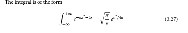

So I had to use this initial momentum and multiply it by a plane wave (sure you are aware of the exp[i(px+p^2(t)/2m)\hbar] )
setting p-p_0 to q and then coupling all terms together to get an integral of the form where one could complete the square the problem here is the extra q, which seems to force me to to integration by parts. The problem is I can set u=q but if dv is my exponential term what is v? I've never seen how to
\int_{-\infty}^\infty dq(q)exp[-q^2(\frac{\alpha^2}{2}+\frac{it}{2m\hbar})+ q(\frac{ix}{\hbar}+\frac{ipt}{2m\hbar})crud. I'm not sure how to post latex here. I guess this is my second question. To see the above the link is here www.whoisntdavidrinaldi.com\help1.pdf

You are trying to do:
$$\int_{-\infty}^\infty q\exp\left[-q^2(\frac{\alpha^2}{2}+\frac{it}{2m\hbar})+ q(\frac{ix}{\hbar}+\frac{ipt}{2m\hbar})\right ]\; dq$$ ... I tidied up your latex a bit.

if we look at my first equation, and forget about the extra q lying around, we get something of the form
##\int_{-\infty}^\infty \exp [-x^2+x]dx##
or $$\int_{-\infty}^\infty \exp [-x^2-x]dx$$
do have solutions..it's just that this new q makes me need to use integration by parts as well.

... well $$\int\exp[ax-bx^2]dx = \frac{\sqrt{\pi}}{2\sqrt{b}}\exp \left[\frac{a^2}{4b}\right]\text{erf}\left[\frac{2bx-a}{2\sqrt{b}}\right]+c$$ ... but you have an integral of complex exponential so you could try to express is as a sum of sines and cosines.

Integrating your version by parts:
$$\int xe^{-ax^2-bx} dx = \frac{b\sqrt{pi}}{4a^{3/2}}e^{\frac{b^2}{4a}}\text{erf}\bigg(\frac{2ax+b}{2\sqrt{a}}\bigg)-\frac{1}{2a}e^{-x(ax+b)}+c$$
I've still got the nagging feeling you should also separate real and imaginary parts - especially considering you'll end up taking the complex conjugate after.
Why don’t you complete the square in the integral?
let a = α2/2 + ipt/2mhbar
b = ix/hbar + ipt/2mhbar
e-(a + b*b/4a*a)∫qe(b/2a-q)*(b/2a-q)dq
and making the substitution q’ = b/2a-q
I get
e-(a + b*b/4a*a)[(b/2a)e-q’*q’-√(π/4)erf(√q’) ]
