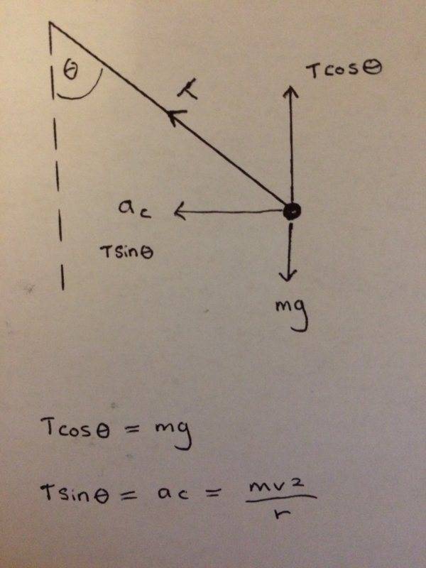

I tried to draw a quick diagram of what I think is happening here
Does the question imply that this object is undergoing horizontal circular motion in the shape of a conical pendulum?
Almost, but the radius will decrease.

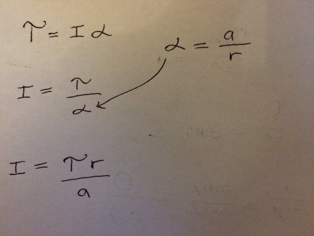

I also tried this, but I cannot get moment of inertia as I do not know torque, radius nor linear acceleration.
Moment of inertia of a point particle about a given axis is very simple. It's just mr2.

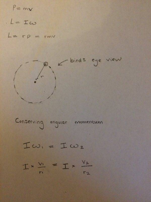

Okay so if they could be expecting me to use conservation of angular momentum. I know that as the string gets wrapped around the peg, radius gets smaller thus the angular velocity must increase for angular momentum to be conserved.
However when I set up the equation. I see that I get 2 different angular velocities on either side, hence I deal with 2 different linear speeds and radius lengths. How would I go about this then?
I tried viewing this scenario in birds eye view, so looking down at the object from above where the dot in the centre represents the central axis. This would be one way looking at the motion in a one dimensional manner.

You have not used what I told you about angular momentum of point particles.
The I will change too.
In fact, for point particles you don't need I, you can just use linear momentum x perpendicular distance.
If v and r are orthogonal, ##I\omega=mr^2\omega=mvr##

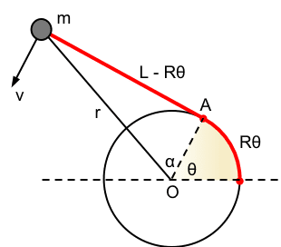

Here is the figure accompanying my interpretation of the problem. It shows a bird's eye view of mass ##m## sliding on a horizontal frictionless plane at the end of a string of total length ##L## (red line). Angular momentum is not conserved about the center axis of the peg (point O) but is conserved about the point where the string loses contact with the peg (point A).
I would assume that the problem is asking for the instantaneous moment of inertia ##I_O=mr^2## about point O as a function of time.

Conservation of mechanical energy means the speed is constant. Tension is ##\frac{mv^2}R##. This exerts a torque ##r\frac{mv^2}R## about the central axis. The particle's angular momentum about that axis is ##mvR##, so ##mv\dot R=-r\frac{mv^2}R##. Solve.

Are you saying that we have a conical pendulum in which case my diagram in #7 is a projection in the horizontal plane?

Yes, except it is only really valid to reduce it to its projection in the horizontal plane if the particle's trajectory lies in such. As I posted, I believe in practice it will rise a little as the radius reduces.

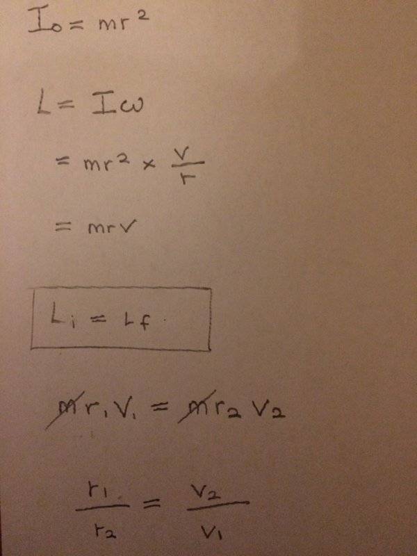

Is this what you mean when you say the mass is irrelevant so cancels out? I got the ratio of the radius to be equal some ratio of the speeds.

Yes, that seems to be what the question setter has done (erroneously).

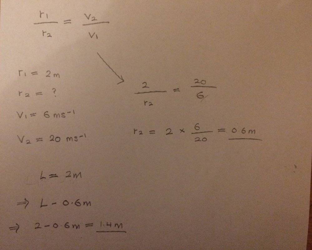

Then subbing the values I need from the Q, I get r_2 to be 0.6m. So the length that gets wounded around the peg is 2m – r_2 = 1.4m
But I still cannot see why mass does not need to be used to find moment of inertia? Both I = mr^2 and and I = angular momentum/ angular velocity both involve a m in the equation. I can't see where m cancels out :oldconfused:

The numerical answer of 1.40 m can be obtained under the assumption that the motion takes place in a horizontal plane as indicated in post #7. The charitable interpretation (it's Christmas season after all) would be that the question setter acted negligently rather than erroneously.
The question does not explicitly say that the string and object form a conical pendulum. It could well be that the object is moving on a horizontal frictionless surface, where the string is winding around a spindle. Yes, the question as posed is annoyingly vague.
In the image you posted in #14 there is an equation with a crossed out m each side. Looks like cancellation to me.
Yes but that is for when I was dealing with angular momentum. If I want to give the instantaneous moment of inertia at the beginning, I see I=mr^2 where r =2 m? So my I = m(2)^2 = 4m. This doesn't seem like a complete value to give :(
Ah, ok.
No, you do not have the mass, and if the conical pendulum interpretation is correct you do not have the radius either. So you can only express the MoI in abstract form.
