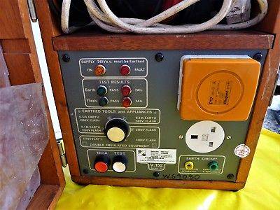

In order to do some welding a long way from a power socket, I have made up a 200m long ‘extension lead’ from some 6mm2 armour cable. The cable is needed for another job later on.
I have an test unit that:
1. Checks earth/ground bond with 8Vac and 25A.
2. Then measures insulation resistance between L+N and Earth at 1250Vac.
The Earth test passed, but the IR test failed (trip at 4mA).
However, when I repeated the IR test using a 1000Vdc (another tester - I like testers) the test passed (IR >10Gohm).
Why? I see two possibilities:
1. 1250Vac has a much higher peak voltage than the DC 1000V.
2. The ac test was affected by wire-wire capacitance.

Yes, the tester (Clare v154) is really for appliances and normal extension leads. The DC tester, a Megger BM10, has a range of DC outputs from 50V to 1000V and is the tool for testing long cable runs. Also very handy, at lower voltages, for testing transformer and motor windings, and for similar checks on car alternators at the 50V setting. Other uses - capacitor leakage, diode reverse breakdown, MOV breakdown...

I was really testing to ensure adequate Earth bonding to the armour. The IR was part of the test sequence of the machine, but it was a surprise when it failed.

In my opinion, if you used Clair v154 tester at 1250 V 50 Hz then it was not IR test executed but:
AC HiPot Test Programmable Voltage Range 0.10 kV-5.00 kV (10V/Step) Frequency Independent of Supply 50 or 60 Hz Voltage Display and Accuracy 0.10 kV-5.00kV ±1% ± 5 Counts Voltage Display Resolution 0.01kV Current Display and Accuracy 0.01mA-20.00mA ±1% ± 5 Counts Current Display Resolution 0.01mA Selectable Range of Pass/Fail Levels* 0.01mA-20.00mA Maximum Current Output 20.00mA @5kV Optional Arc Detection 9 Levels
according to Instruction Manual:
http://www.seaward.co.uk/downloads/clare_hal_combined_user_manual_455a553_154_538_rev12_v1.pdf
page no.90
20 mA for 6 kV then 4mA for 1200 V. So 1200 V it is ok for 20 m only. For 200 m you need 40 mA at least-may be.

That manual’s for a different machine. Mine is like this:
The Clare/Seaward HAL is much more modern and on a different level in terms of cost and functionality.
The old 152 and 154 do an excellent 25A test of the Earth path, to ensure not only continuity but also integrity of the Earth path. Any feeble/frayed/corroded connections will be revealed.
