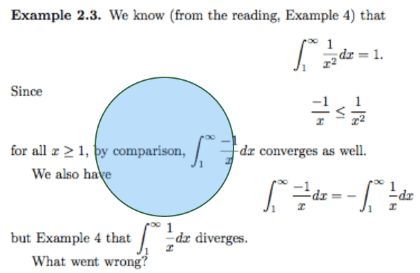

The big blue circle has been put there by my math prof to denote the location of the error in the following solution. Why is this an error? I'm lost. :(

$$\int_1^{\infty}\frac1x \, dx$$
does not converge. If you were to try to get an antiderivative, the only candidate is $\ln|x|$, so formally, you'd have
$$\int_1^{\infty}\frac1x \, dx = \ln|x|\big|_{1}^{\infty} =\ln(\infty)-\ln(1)=\ln(\infty)=\infty.$$
So it doesn't converge.

Comparison is fine, but it must be a VALID comparison. The idea would be capsulized as "closer to zero".
Bad Example: It is also true that for [tex]x > 1[/tex], we have [tex]-e^{x} < \dfrac{1}{x^{2}}[/tex], but that is not helpful.
In other words, your comparison must be on the same side of the x-axis.

Can you explain what you mean by the fact that the "comparison must be on the same side of the x-axis"?
You error is that the "comparison test" applies only to positive functions. You cannot just say that [math]-\frac{1}{x}< \frac{1}{x^2}[/math]. Sometimes you can use the absolute value but it is NOT TRUE that [math]\left|-\frac{1}{x}\right|= \frac{1}{x}< \frac{1}{x^2}[/math].
Well, BOTH positive, sure, but also BOTH negative would do.
But "the other way around". If f(x) and g(x) are both positive with f(x)< g(x) and $\int g(x) dx$ converges then $\int f(x) dx$ converges.
If f(x) and g(x) are both negative and f(x)< g(x) (so that |g(x)|< |f(x)| and $\int f(x)dx$ converges then $\int g(x) dx$ converges.
