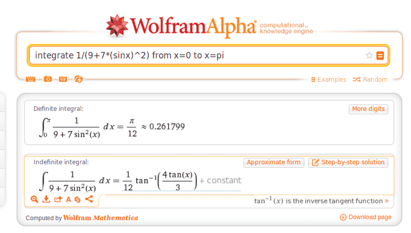

I meant: you are not a young student looking for solutions to a homework; so. I tought you were a technician or a researcher needing that integral for some computations. In such cases, the fast way is just Wolfram Alpha.
nikolafmf said:
Anyway, I want to integrate the function by pencil and paper, not by computer algebra software, calculator or any electronic device. I will be very thankful about any hint.
Reading also what you have written in the merged thread, now I understand you are not looking for a solution for that particular integral, but rather for an explanation of what "integral" means...
Well, if this is the case, to solve
[itex]\int[/itex] 0 π f(x) dx
with
f(x)=1/(9+7*(sin x)2)
you have to:
1) find a primitive, AKA indefinite integral, AKA antiderivative (http://en.wikipedia.org/wiki/Antiderivative) of f(x), i.e. a function F(x) whose derivative is just f(x).
Of course, if F(x) is such a function, also F(x)+k (with any number in place of k) is a primitive of f(x), given that the derivative of a constant is zero.
2) compute F(π) - F(0). Of course, with any k, F(π) + k - [F(0) + k] will give the same numerical result.
The latter point, 2), is due to the Fundamental theorem of calculus http://en.wikipedia.org/wiki/Fundamental_theorem_of_calculus. It's demonstration is rather intuitive, have a look.
For what concerns point 1), while finding the derivative of a function can be tedious but is straightforward using simple rules, finding a primitive is often considerably hard. There are some techniques and some tricks that can be attempted, hoping that they could lead to the solution: but knowing in advance which could be more promising is a matter of experience (acquired after several homeworks :- ). Other post in this thread have suggested you some ways.
On the contrary, once somebody or some software has found the primitive you need (Wolfram Alpha gave it in the section "indefinite integral"), checking that it is the right solutions requires only to derive it.
