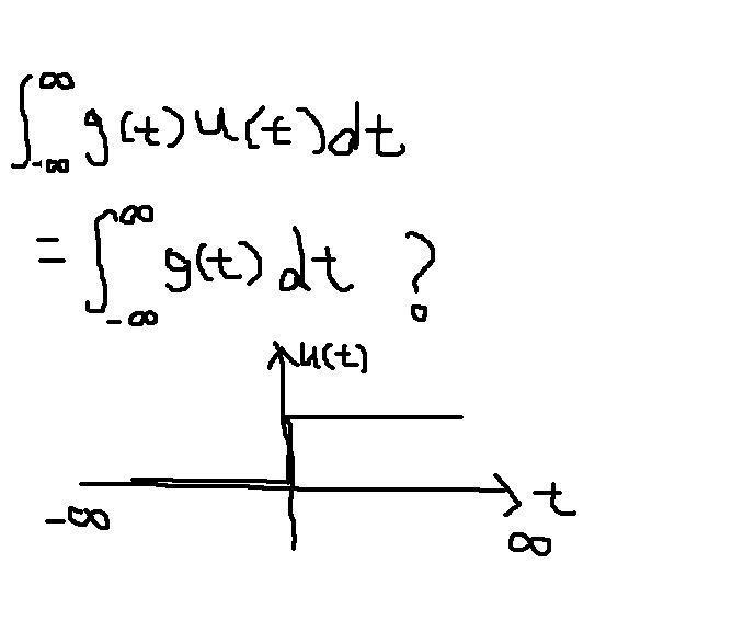

Hi,
i have a problem with integration a function with a unit step function.
Given,
Handwritten integral from negative infinity to infinity of g(t) u(t) dt, followed by a question mark and an equals sign with the integral from negative infinity to infinity of g(t) dt. Below is a sketch of the unit step function u(t) on axes labelled t, with the step rising at t = 0.
Refer to the image, i dun understand is that u(t) is equal to 1 from a definite integration from -[tex]\infty[/tex] to [tex]\infty[/tex] since u(t)=1 from -[tex]\infty[/tex] to 0 and u(t)=0 from 0 to [tex]\infty[/tex].
Thanks.

Isn't it the other way around like in your drawing? I.e., that u(t) = 0 for t < 0 and u(t) = 1 for 0 <= t < infinity?
That means that
[tex]\int_{-\infty}^{\infty} g(t) u(t)dt = \int_0^{\infty} g(t) dt[/tex]

so if i have muliplication of few unit step function like in the image below,
Handwritten work: the integral from minus infinity to infinity of g(t)u(t)u(t+2) dt, with u(t) step graphs multiplied to give u(t) times u(t+2) and a shaded region from 0 to infinity, then 'the ans: integral from 0 to infinity of g(t) dt' with a question mark.
am i right this way?
