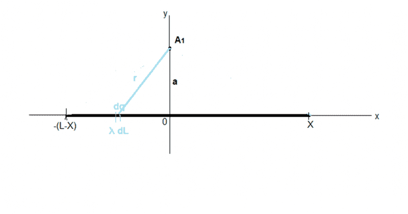

Okay, so I think I found out a way to do it without using Gauss' Law. I'll upload an image so you can better see what I did. There was a lot of integrating going on so I hope it's right!
I started out with [tex]E = {\frac{1}{4 \pi \epsilon_0}} {\frac{Q}{r^2}}[/tex]
[tex]dE = {\frac{1}{4 \pi \epsilon_0}} {\frac{dQ}{r^2}}[/tex]
[tex]dQ = \lambda dL[/tex]
[tex]dE = {\frac{1}{4 \pi \epsilon_0}} {\frac{\lambda dL}{r^2}}[/tex]
Now I'm going to use a definitive integral and for that you might want to check out my amazing drawing made in MS paint.
[tex]E = {\frac{\lambda}{4 \pi \epsilon_0}} \int_{-(L-x)}^x {\frac{}{a^2 + L^2}} dL[/tex]
I went ahead and focused on just the integral (indefinite) so it would be easier to calculate.
[tex]\int {\frac{1}{a^2 + L^2}} dL[/tex] I'll substitute L= a.u and so dL=a.u du and that I *think* I can simplify to dL= a du so:
[tex]\int {\frac{1}{a^2+ a^2u^2}} a du = {\frac{1}{a}} \int {\frac{1}{1+u^2}} du = {\frac{1}{a}} arctg (u)[/tex]
and since I substituted L= a.u I can re-substitute u=L/a so:
[tex]{\frac{1}{a}} arctg ({\frac{L}{a}})[/tex]
and so
[tex]{\frac{\lambda}{4 \pi \epsilon_0 a}} [arctg {\frac{L}{a}}]_{x-L}^x ={\frac{\lambda}{4 \pi \epsilon_0 a}} (arctg {\frac{x}{a}} - arctg {\frac{x-L}{a}})[/tex]
Am I correct?

Impressive amount of work! Kudos! I'm afraid something goes wrong, though: all these little ##\lambda dl ## contributions are vectors and have to be added up as vectors. That means for one component a sine comes in and for another component a cosine. That changes the outcome of the integral(s)...
Thank you, it took me a long time. Please tell me it's not all worthless.
Could I split the integral into two? Have one go from (x-L) to 0 and another from 0 to x ? And instead of [tex]{\vec {\lambda \cdot dL}} = \lambda dL cos \alpha[/tex]
aaand ... could alpha be ... a/r ? But I do not know the length of r.
How would I get a sine for one side and cosine for the other side? I just used a known formula for a scalar multiplication of vectors.
Here you have an example of the great value of a picture: your nice drawing and Pythagoras will tell you !
Note: you make life difficult with a coordinate system that moves with the point where you want to calculate the field. Easier to have the origin in the midpoint of the wire.
Unless the point O is actually halfway between -(L-X) and X and you forgot to tell us. In that case there a drastic simplification is in sight !

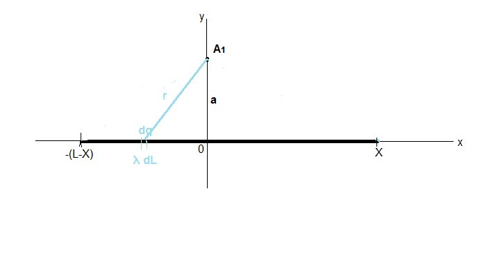

I just went to check the actual problem (there was a drawing with it) and on one side of point A there is L/2 so I guess I just don't know how to read and so: yes, A is over the center or the wire. (I apologize for messing it up. I wasn't aware of it and I'm a bit mad at myself, as well)
I like simplifications! They make my life sound a bit easier! :D
Good. No worry, I almost saw that coming :smile:. And it makes your work easier -- which is good after this elaborate ##\arctan## stuff :wink:.

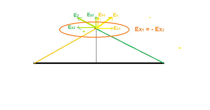

First the elimination of Ex : from symmetry. It wouldn't matter if you calculated it for the situation with the coordinate system mirrored (x'= -x) so if any of the two would give an x component of the field there would be two different solutions, and the field is unique (being a solution of the Laplace eqn -- but perhaps that's for later).
Now the y component. dL is small, but that's not r times dEx/dE ! ##dq = \lambda dL ## is also not the smartest naming choice for your integration, which is over x and x is running from -L/2 to L/2. Much clearer to say ##dq = \lambda dx ## and do $$\int_{-L/2}^{L/2} ... \lambda dx\ .$$ And now you see how to express ##\cos\theta## and the other stuf on the dots in terms of x (and some :smile: constant)

So now that we know that A is in the centre of the wire we can say that whichever Ex we have coming from one side will have an equal but opposite Ex coming from another point at the other side? So they would cancel each other out?

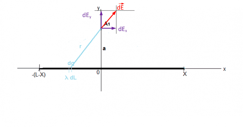

Okay. I'm going to try again.
I'm still using [tex] E = {\frac{1}{4 \pi \epsilon_0}} {\frac{Q}{r^2}}[/tex]
and so
[tex] {dE} = {\frac{1}{4 \pi \epsilon_0}} {\frac{{dQ}}{x^2 + a^2}}[/tex]
I can also use that [tex]\lambda = {\frac{Q}{L}} = {\frac{dq}{dx}}[/tex] and so that would be the [tex]dq = \lambda dx[/tex] that you wrote out.
Can I say that [tex]dE_x = dE . cos \alpha[/tex] if ##\alpha## is the angle between dE and dEx ?
so I would get [tex]dE_x = {\frac{1}{4 \pi \epsilon_0}} {\frac{{\lambda dx}}{x^2 + a^2}} cos \alpha[/tex]
[tex]{\frac{\lambda}{4 \pi \epsilon_0}} {\frac{cos \alpha}{x^2 +a^2}} dx = {\frac{\lambda}{4 \pi \epsilon_0}} {\frac{{\frac{a}{\sqrt{a^2 + x^2}}}}{x^2 +a^2}} dx = {\frac{\lambda a}{4 \pi \epsilon_0}} {\frac{1}{(x^2 +a^2)^{{\frac{3}{2}}}}} dx[/tex]
and then I would integrate so it would look like this
[tex]E = {\frac{\lambda a}{4 \pi \epsilon_0}} \int_{{\frac{-L}{2}}}^{{\frac{L}{2}}}{\frac{1}{(x^2 +a^2)^{{\frac{3}{2}}}}} dx[/tex]
Is this right?
Yes. Mirror symmetry.
ing_it said:
Can I say that ##dE_x=|d\vec E|\cos\alpha## if ##\alpha## is the angle between dE and dEx ?
You certainly can !
ing_it said:
Is this right?
It most certainly is ! (But you need to convince yourself :smile:, apparently ? Just teasing, all in good spirit).

Thanks! :) We took integrals in our 1. semester math, but nothing like this! But I just hate substitutions like this because to me, it's not intuitive at all.
I made a stupid simplification that just made it all harder. tried it without said simplification and suddenly tada! Got it.
I got that ## E_x = {\frac{\lambda a}{4 \pi \epsilon_0}}{\frac{L}{a^2 \sqrt{{\frac{L^2}{4}}+ a^2}}} ##
Okay and as for [tex]{\frac {\lambda a}{4 \pi \epsilon_0}} \int_{-inf}^{-L/2} {\frac{x}{a^2 \sqrt{x^2+a^2}}}[/tex]
Down here through L'Hospital's law I got:
[tex]{\frac{-L/2}{a^2 \sqrt{{\frac{L^2}{4}}+a^2}}} - lim_{y\rightarrow \inf} {\frac{y}{a^2 \sqrt{ y^2+a^2}}} = {\frac{-L/2}{a^2 \sqrt{{\frac{L^2}{4}}+a^2}}} - 0 = {\frac{-L/2}{a^2 \sqrt{{\frac{L^2}{4}}+a^2}}}[/tex]
and for ## {\frac{\lambda a}{4 \pi \epsilon_0}} \int_{L/2}^{inf} {\frac{x}{a^2 \sqrt{x^2+a^2}}} ##
[tex]lim_{y\rightarrow \inf} {\frac{y}{a^2 \sqrt{ y^2+a^2}}} - {\frac{-L/2}{a^2 \sqrt{{\frac{L^2}{4}}+a^2}}} = 0 - {\frac{-L/2}{a^2 \sqrt{{\frac{L^2}{4}}+a^2}}} = - {\frac{-L/2}{a^2 \sqrt{{\frac{L^2}{4}}+a^2}}}[/tex]

Edit: One more question. I started marking Ex and we just went with it but now that I'm re-writing this I notice that I think it should have been Ey but that maybe Ey = E (thanks to the mirror symmetry) so that I could leave the index out altogether
Done. And well done.
Wiseguys notice that $$
{\frac{L/2}{\sqrt{{\frac{L^2}{4}}+ a^2}}}
$$is the sine of some angle: half the angle at which the line charge is 'seen' from point A. That sine goes to 1 if ##L\rightarrow\infty## (or ##a\downarrow 0##).
OOOh, I see it now. Since ##{\sqrt{{\frac{L^2}{4}}+ a^2}}## is basically r? And L/2 could be x. I didn't notice that but I think it's the better way of explaining it!
I think you missed my last question: I started marking that partial intensity Ex and we just went with it but I think it should have been Ey (because of the way I drew my drawing) but that maybe Ey = E (thanks to the mirror symmetry) so that I could leave the index out altogether, couldn't I?
