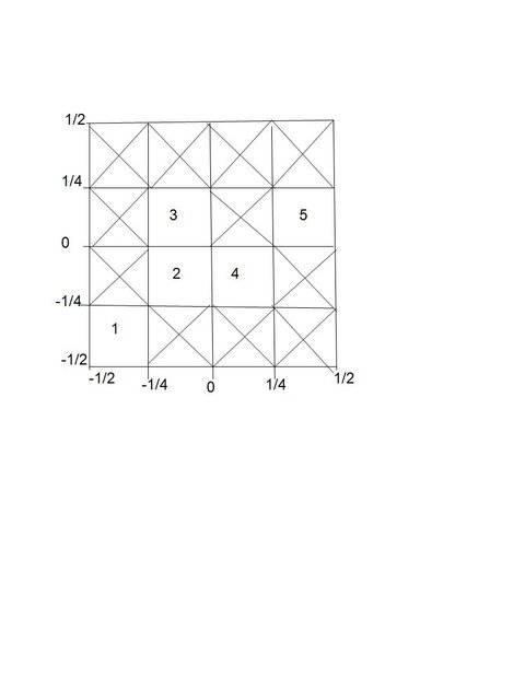

Please see attached photo.
Intensity proportional to Amplitude of E-field squared.
When the crystal above is illuminated with light of intensity ##I_0##, what is the intensity at the central maximum? (The picture shown above is a 4 x 4 unit cell of the crystal)
The answer is ##(\frac {5} {16} )^2 I_0##. Why?
Apparently, Electric field is proportional to the transparent area, and will be maximum if the whole unit cell is transparent. I feel that it should be intensity that's proportional to the transparent area instead?
I cannot see how amplitude of electric field is related to transparent squares.

From diffraction theory, the intensity of the primary maxima for ##N ## sources (in phase), (or for a single slit diffraction pattern made from ## N ## sources), is proportional to ## N^2 ##, because the resultant electric field amplitude ## E ## is proportional to ## N ##. The reason energy is conserved is that for ## N ## sources, the angular width of the diffraction pattern (central maximum) ## \Delta \theta \approx \frac{\lambda}{b} ##, where ## b ## is the width of the ## N ## sources, (e.g. arranged in a square), so that the solid angle of the maximum, which is proportional to ## (\Delta \theta )^2 ##, is inversely proportional to the total area of the sources. Thereby the solid angle of the diffraction maximum is inversely proportional to ## N ##. The power is a product of the intensity and the solid angle. It turns out the power in the entire maximum for ## N ## sources will be proportional to ## N ##. The peak goes as ## N^2 ##, but the solid angle spread goes as ## \frac{1}{N} ##.

And the "book" answer is that the forward amplitude is proportional to the corresponding (0,0) Fourier component which is just the normalized integral. But I like the @Charles Link explanation also..

I analyze this problem using Fraunhofer diffraction theory, to whit, the complex amplitude of the diffracted wave is,
U(z,y,z)\propto \int \int_{Aperture}A(x^{'},y^{'})e^{-i\frac{2\pi}{\lambda}(ux^{'}+vy^{'})}dx^{'}dy^{'}
where ##A(x^{'},y^{'})## is the complex amplitude over the surface of the aperture. I wave my hand and declare the constant of proportionality is ##\sqrt{I_0}##, and refer to the diagram below for the limits of integration in the five transparent regions of the unit cell.
U_1= \sqrt{I_0}\int_{-\frac{1}{2}}^{-\frac{1}{4}}e^{-i\frac{2\pi}{\lambda}ux^{'}}dx^{'}\int_{-\frac{1}{2}}^{-\frac{1}{4}}e^{-i\frac{2\pi}{\lambda}vy^{'}}dy^{'}
=\sqrt{I_0}\frac{e^{-i\frac{2\pi}{\lambda}ux^{'}}}{-i\frac{2\pi}{\lambda}u}|_{-\frac{1}{2}}^{-\frac{1}{4}}\frac{e^{-i\frac{2\pi}{\lambda}vy^{'}}}{-i\frac{2\pi}{\lambda}v}|_{-\frac{1}{2}}^{-\frac{1}{4}}
=\sqrt{I_0}\frac{e^{i\frac{\pi}{4\lambda}(3u+3v)}}{16}sinc(\frac{\pi u}{4\lambda})sinc(\frac{\pi v}{4\lambda})
in likewise manner we compute,
U_2=\sqrt{I_0}\frac{e^{i\frac{\pi}{4\lambda}(u+v)}}{16}sinc(\frac{\pi u}{4\lambda})sinc(\frac{\pi v}{4\lambda})
U_3=\sqrt{I_0}\frac{e^{i\frac{\pi}{4\lambda}(u-v)}}{16}sinc(\frac{\pi u}{4\lambda})sinc(\frac{\pi v}{4\lambda})
U_4=\sqrt{I_0}\frac{e^{i\frac{\pi}{4\lambda}(-u+v)}}{16}sinc(\frac{\pi u}{4\lambda})sinc(\frac{\pi v}{4\lambda})
U_5=\sqrt{I_0}\frac{e^{i\frac{\pi}{4\lambda}(-3u-v)}}{16}sinc(\frac{\pi u}{4\lambda})sinc(\frac{\pi v}{4\lambda})
We sum the individual contributions and find the intensity by taking the dot product of ##U## with its complex conjugate.
U=U_1+U_2+U_3+U_4+U_5
I=U\cdot U^{*}
=\frac{I_0}{(16)^2}sinc(\frac{\pi u}{4\lambda})^2sinc(\frac{\pi v}{4\lambda})^2[5+4\cos(\frac{\pi}{2}(u+v))+2\cos(\frac{\pi}{2}(u+2v))+2\cos(\frac{\pi}{2}(2u+v))+2\cos(\frac{\pi}{2}(3u+2v))+2\cos(\frac{\pi}{2}(u))+2\cos(\frac{\pi}{2}(v))+2\cos(\frac{\pi}{2}(u-v))2\cos(\frac{\pi}{2}(4u))+2\cos(\frac{\pi}{2}(4u+2v))]
We evaluate this at the center of the cell to find ##I=I_0\frac{(5)^2}{(16)^2}##.
