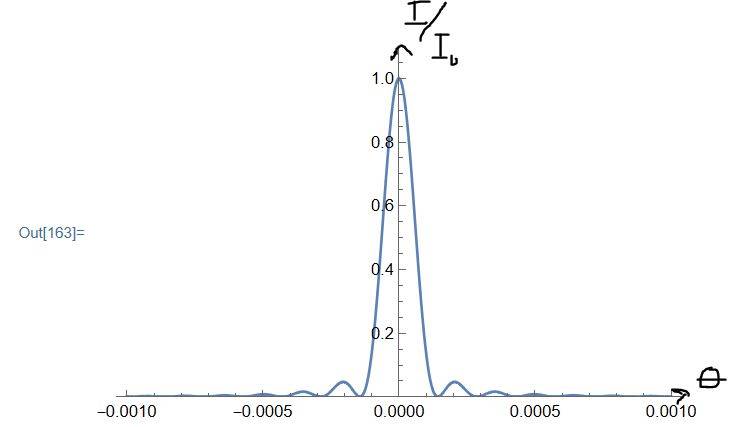

In a single-slit diffraction experiment, a monochromatic light of wavelength ##\lambda## is passed through one slit of finite width ##D## and a diffraction pattern is observed on screen.
For a screen located very far away from the slit, the intensity of light ##I## observed on the screen in units of its maximum value ##{I_0}## and in terms of ##sin(\theta)##, where ##\theta## is the angle between the slit and a position on the screen, is represented in figure1 attached below.

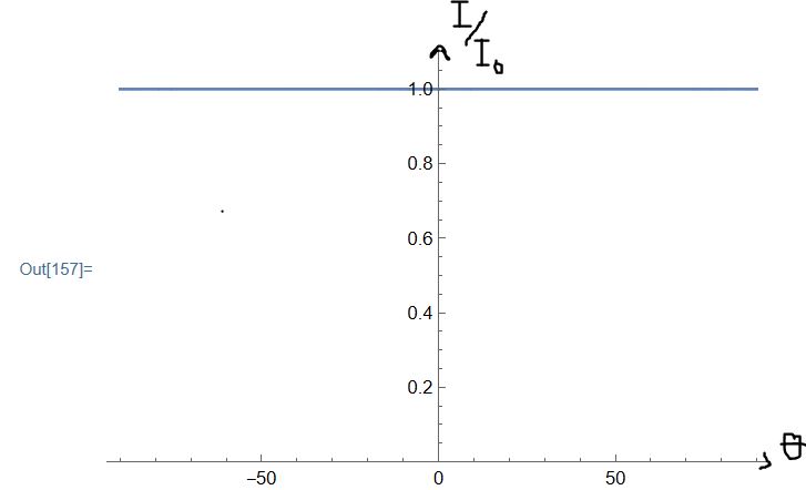

If we let ##D=4 \times 10^{-9} m ## and ##\lambda= 1 \times 10^{-6}m##, ##I(\theta)## will have the form in figure 2.
If we immensely increase the width of the slit to become ##D=4 \times 10^{-1}m## and keep the wavelength ##\lambda## to be the same , ##I(\theta)## will have the form in figure3.
You can see that in case ##D## is very small ( ##D= 4 \times 10^{-9}m##), the intensity on the screen will be maximum along the whole screen, but when we increase the width ##D## to reach ##4 \times 10^{-1}m##, the intensity of light on the screen will just be maximum on the center of the screen, but will be null on the rest.
What is confusing me is that if we suppose that in the both cases the same amount of light is entering the slit, shouldn't the total energy on the the screen be the same for the two cases? By comparing the intensities in the two cases, it is clear that the total energy that would be detected on the screen for case ##D=4 \times 10^{-9}m## will be higher than that of the case when ##D=4 \times 10^{-1}m##. Doesn't this violate the law of conservation of energy? since the same amount of light got emanated from the slit , so we expect to detect the same amount of total energy or the same total intensities in the both cases.
Note that ##I(\theta)=I_0\Big(\dfrac{sin(\frac{\beta}{2})}{\frac{\beta}{2}}\Big)^2##, where ##\beta=\dfrac{2\pi Dsin(\theta)}{\lambda}##
Graph of normalized intensity I/I0 against sin(theta), showing a flat horizontal line at I/I0 = 1.0 across the plotted range, with no diffraction minima visible.Plot of normalized intensity I/I0 against angle theta from -0.001 to 0.001 rad, showing a single-slit diffraction pattern with a tall central peak at 1.0 and small side lobes.Graph of intensity against sin θ for single-slit diffraction: a central peak at 0 with side lobes, marked at ±λ/D, ±2λ/D and ±3λ/D on the horizontal axis.

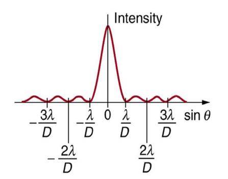

Looking at three sketches you show, higher the peak, narrower it is. Total energy through the slit get larger for higher and broader peaks. In your speculation are these two features considered ?
But the peak of the intensity for the two cases is ##I_0##, which is the same. It is the same because, as I said in the post, I am assuming that the same amount of energy is entering through the slit and I also assumed that the wavelength of light is the same for the two cases. Off course, when I increase the width ##D## of the slit, the total intensity ##I## of light passing through the slit will decrease but the peak ##I_0## will still the same.
what is making me confused is that when ##D## is large the total intensity detected on the screen will be much lower than when ##D## is small. As the intensity is defined to be energy per unit area, and provided that we didn't change the dimensions of the screen in the both cases, shouldn't the total intensity be the same for the both cases, or otherwise energy would not be conserved?

I have read through most of this thread but the whole thing pivots on this statement. If the "same amount of light is entering the slit" then the maximum intensity of the diffraction pattern will have to be the same. BUT this is not a realistic experiment to discuss. You would have to put a variable density filter in front of the slit in order to obtain that condition.
The usual experiment to discuss and to carry out would use uniform illumination of the slit and the total energy through the slit would be proportional to the width. The Fraunhofer Integral for the diffraction pattern is (half way down) in this link. The quantity "a" represents the amplitude of the incident plane wave on the slit. The width of the slit sets the limits for the integration.
Note: If you come across a result that you think is violating basic stuff like conservation of energy then it is pretty certainly that there is no actual violation. You have to follow any calculations carefully and not miss out any steps. Do that and you will get 'the right / accepted answer' (unless you are a potential Nobel Prizewinner :smile: ). If you can't / won't follow the Maths then you really just have to believe the standard result.

I think your comment resolved the issue. Indeed, my whole issue was pivoting around my claim that the "same amount of light would enter the slit", which is a wrong claim or at least very hard to make it feasible. I was ignoring the fact that the source of light that I'm illuminating into the slit also encounters the obstacles beyond the slit. Therefore, the total energy through the slit will inevitably increase when we increase the width of the slit and decrease when we narrow it. Moreover, when the total energy through the slit increases, the maximum intensity of the diffraction pattern will increase, and will decrease when the total energy through the slit decreases. Thank you.
