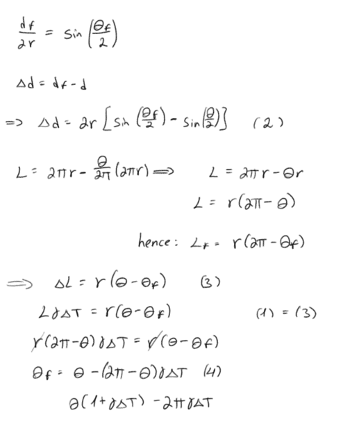

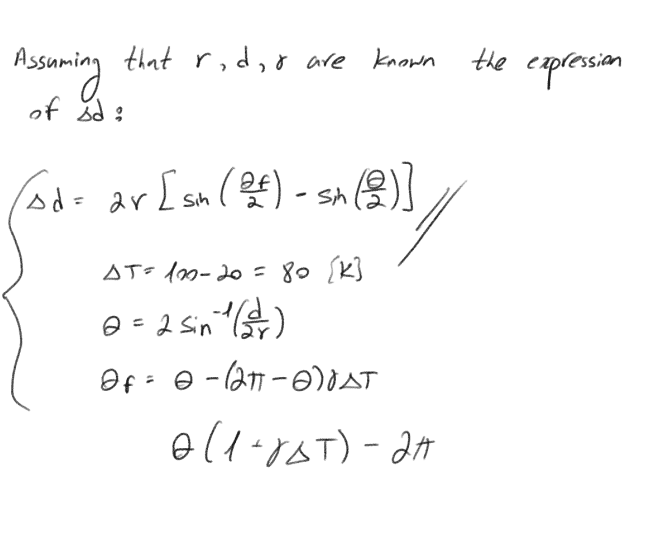

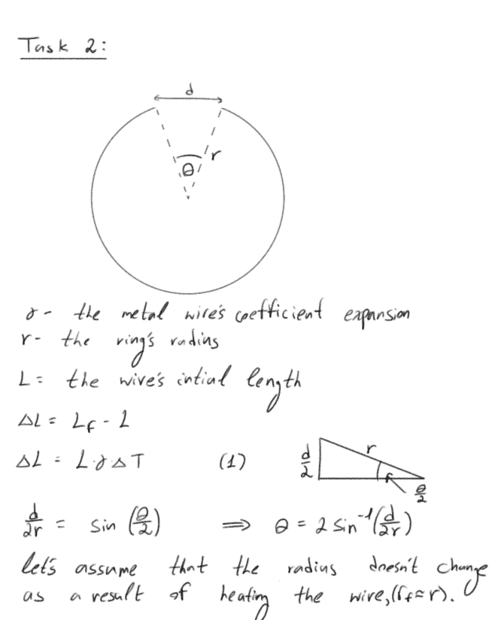

A metal wire ring has a cut of the width d. The ring is at a temperature of 20 degrees C.
If one heats the ring up to the temperature of 100 degrees C, how will the width of the cut d change?
(You can assume that the full geometry of the ring with cut is known).
I would love to know what you think about my solution. Do you think the assumptions are correct?
can you try to explain qualitatively how d will change with the increasing temperature and why?

OP's work:
You assume that the radius does not change. Is this a reasonable assumption? For a closed ring the radius changes by the same fraction as the perimeter of the ring. What if you mark two points on a closed ring and measure the cord between the points at the two temperatures?

Thanks for the comment. But what about this case where the thermal expansion is not in the linear direction but in the angular direction? (Maybe I'm wrong)
I tried to think of it as a horizontal wire that grew in length as a result of the heating from which the ring is made. When there is a complete ring the length of the wire increases and therefore the radius must increase, but when the ring has a cut as in this case, the expansion of the wire can go to closing the the cut or part of it so that the radius remains as it was.
My calculations were based on this assumption.

Unconstrained thermal expansion is isotropic, and occurs equally in all directions. What does “geometrically similar “ mean to you?
Thank you again. This means that the objects look exactly alike except for the fact that they are of different sizes.
So my assumption was wrong. Can it be said that in this case the width of the cut d will necessarily increase?
Yes!!! It's like taking a photograph at the lower temperature and then taking it again at the higher temperature. The second photo is an enlargement of the first by a factor of ##(1+\alpha~\Delta T)## (see post #5).
The thermal expansion of an isotropic solid is isotropic (unless the solid is constrained; not the case here). This means that all the dimensions change by the same fraction.
