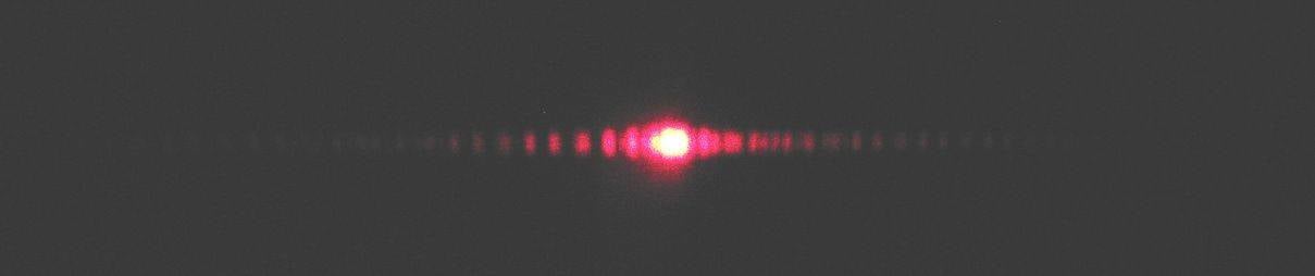

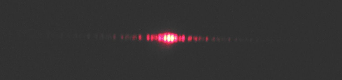

I just acquired a new (to me) HENE laser and tried to create the pattern as described in Case 1. IMG_0096.JPG is a normal double slit, .35mm center with two .15mm slits. For image IMG_0097.JPG, I changed the slits to .1mm on the left and .4mm on the right. I will try to get better images when I have the time but there does seem to be a difference between the two sides.
