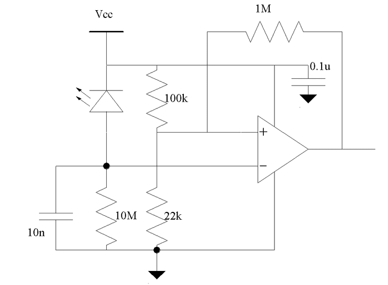

guys I'm making this color sensor.i have used 2 RED LEDs as both sensor and emitter. I have used TL084 op amp in infinite gain mode because Sensor LED generates very small voltage.
my problem is op amp is too sensitive so it reacts when i tough circuit or negative wire (some times even my fingers reach the circuit [without even touching])
this made circuit kind a unstable.other than that circuit works fine.
any solution for this?
here is the schematic
thanks
reduce its gain by changing 2M resistor to something like 100K or 10K.

well i use another LED to emitte light so voltage generated on sensor LED is small.

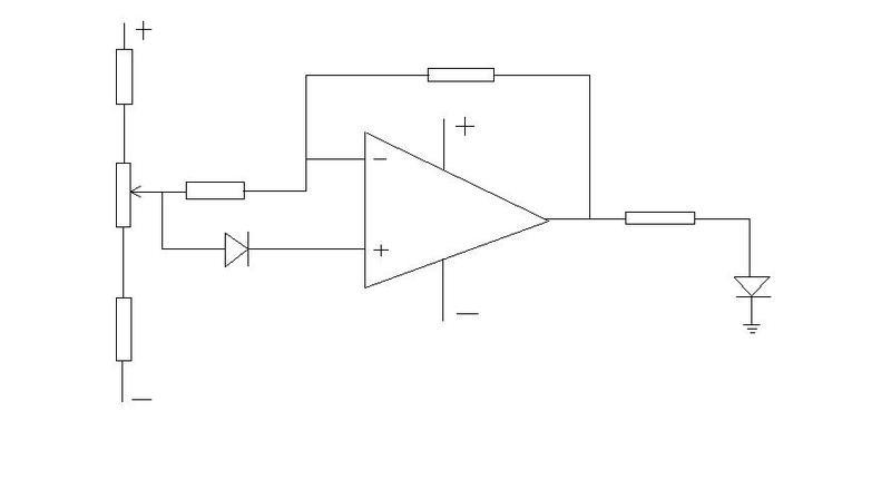

anyway i think i solved it with this circuit
Looks like that would give a voltage comparator action.
ie your output light would be either on or off.
Is that what you want?
yup.just to detect black or white surface

If I were interviewing you for an electronics job, and I asked you to draw me a circuit to detect light, and you drew me that "fixed" circuit, what do you think would happen next?
I checked the TL084 data sheet and it shouldn't have a voltage less than 7 volts as a supply.
Also it does not say you can operate inputs close to or at either supply voltage rail, so you probably can't.
So, you are probably losing a lot of sensitivity by using this circuit.
However it is your post, so if it seems to be working for you then go for it.
An easy test would be to put a voltmeter across the LED and slowly bring a light close to the LED. Measure what voltage it takes to make the output change state.

well,i'll increase voltage.anyway do you think this op amp is not suitable to amplify voltage generated in led?.if it can be done with this op amp,can u suggest a circuit?.and also can you suggest a suitable common op amp for this? We can't use 741 here right?.lmc6482 is not available.
ACTUALLY WHAT I WANT DO IS THIS.
I NEED TO MAKE A SENSOR TO DETECT WHITE SURFACE IN BLACK BACKGROUND.SO WHAT I THOUGT WAS BY EMMITING RED LIGHT TO BOTH SURFACES,WHITE WILL REFLECT WHILE BLACK WILL ABSORBE LIGHT.SO IN SENSOR I THOUGT IF LED GENERATES VOLTAGE WHEN RECIEVING LIGHT I CAN USE IT HERE COZ WHITE SURFACE WILL REFLECT LIGHT AND SENSOR LED WILL GENERATE FEW mv WHEN IT RECIEVED THIS REFLECTED LIGHT FROM WHITE SURFACE.SINCE BLACK SURFACE WILL ABSORB LIGHT SENSOR WILL NOT GENERATE ANY VOLTAGE.
SINCE GENERATING VOLTAGE IS LOW AND HAVE ONLY TINY CURRENT I THOUGT FET BASED OP AMP WILL SUIT THIS.BECUSE FET DOES NOT REQUIRE INPUT CURRENT.AND SINCE I WANT DIGITAL OUT(WHITE SURFACE OR NOT) I PUT POTENTIOMETER TO POSITVE INPUT TO SET REFERENCE VOLTAGE.
AND SET SENSOR LED IN REVERSE MODE(positive pin to negative supply and negative pin to inverting input pin).
SO IF VOLTAGE GENERATE ON LED BY REFLECED LIGHT IS LARGER THAN REFERENCE VOLTAGE OP AMP OUTPUT WILL BECOME LOW.OTHERWISE IT WILLBE HIGH.
ACCORDING TO THIS I DESIGN ABOVE CIRCUIT.
SO TELL ME WHATS WRONG WITH IT.
THANKS

That opamp is fine but it can't operate with the inputs close to the supply rails. Most opamps can't do this.
The LED generates a voltage but this will vanish quite quickly if you try to draw current from it. It may require a large resistor to work properly but check that after construction.
If you want on/off output, make the ratio of the feedback resistor and the input resistor to the -ve input as high as possible.
Can you use room lighting instead of the other LED? It would make the job easier.

With a single power supply, you use a resistive divider to form an artificial ground. So this is the "earth" symbol in the diagram. This is normally bypassed with a capacitor to one of the supply rails if you were using it for audio. In this case, it probably doesn't matter.
This is the wiper contact on the pot in the diagram above.
The LED is a voltage generator with a high internal resistance, so it looks odd in this circuit, but as a voltage generator it is normal to put it there.
Just a typo from above:
"It may require a large resistor to work properly"
This would be a large value resistor across the LED. Maybe 2.2 M.

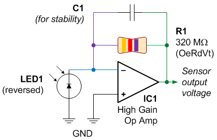

guys take a look at this
http://www.robotroom.com/ReversedLED.html"
anyway i just brought LM324 and replaced one of TL084 IC in my circuit with it (I use 2 TL084 I'M making a 8 LED sensor array for line follower robot). with running 5V supply for both ICs circuit works same as previous (i had to adjust pots used with LM324) except that TL084 has higher amplification.so it works in bright sunllight compare to LM324.
II used circuit published above (one with wrong polarity-you say) I'm not sure how circuit works if polarities are wrong
any ideas?
Finally! That's the current-to-voltage converter circuit that I was referring to! Maybe you have a chance in the job interview after all. Good.
you mean this circuit?
how in this circuit "current-to-voltage converter" thing happens? can you explain me?
I connected a red LED in series with a 100 K resistor across a 7 V DC supply with a meter connected in series with both, and on the 200.0 uA range.
In the forward direction it drew a current of 54uA. In the reverse direction it drew less than 0.1uA. The reading was ZERO. This was regardless of the lighting on the LED.
Even holding a 60 watt lamp less than an inch from the LED produced no measurable current.
This was the same without the 100 K resistor.
This is the same LED that generates 1 volt when placed near the same lamp.
This LED has a resistance of at least 70 Mohms regardless of light levels, and probably more.
I won't hammer the point, but I know which way I would use this device.

2nd circuit
https://www.physicsforums.com/attachment.php?attachmentid=20707&stc=1&d=1253884269"
here i have connected negative pin of LED to negative supply and positive LED pin to inverting input.(forward biased)
result
on black surface-output high
on white surface-output low
so according to you gys 2nd circuit shouldn't work?
so I'm little confused.
any comments?

Yes both of those results make sense (assuming that you are talking about the final output after the 7414N).
In the first circuit the sensor LED anode goes high when illuminated so the opamp output goes low. When the LED is not illuminated the opamp bias current may still give a small forward bias anode voltage, but if it's less than the threshold set at the op-amp non-inverting input then the opamp output goes high.
In the second circuit when the sensor LED is illuminated the cathode goes slightly negative so the opamp output goes high (but only because the LM324 has a common mode range that extends down to VEE - and even slightly below with some small degradation of parameters. Many opamps won't allow this). When the LED is not illuminated the opamp inverting input is essentially floating - and because the LM324 has a pnp input stage the bias currents will make the cathode float high so the output will go low. This really is a very dubious design that only works by good luck really. It is very sensitive to op-amp parameters that may change with temperature or if you use a different opamp type.
Why don't you try the circuit in my attachment. You may have to adjust the value of the 47M resistor to match your LED (lower resistance if too sensitive, higher resistor if not sensitive enough) but it should be a lot less sensitive op-amp parameters and op-amp type.

Why don't you try the circuit in my attachment. You may have to ajust the value of the 47M resistor to match your LED (lower resistance if too sensitive, higher resitor if not sensitive enough) but it should be a lot less sensitive op-amp parameters and op-amp type.
can you explain this circuit please?
is that LED used n photo current mode? and is resistors big like 47M exist? (never heard before)
and is there anyway to add a pot here so i can chage sensitivity-threshhold value?
