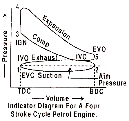

Thanks all for taking part in this disscution. The answer has been found. Here what I've found:
Cycle with backpressure may look like this :
There are two loops in there, the top one is the indicated work that we get from the cycle (W_ind) and the bottom one is called pumping work (W_pump), its actually energy that we lose. By dividing the work by displacement volume we will get mean effective pressures: bmep - brake mean effective pressure ; pmep - pumping mean effective pressure.
the pmep may be approximated as : (p_exhaust - p_suction)*V_displacment
Since backpressure reduces the total work, the new work will this:
W(kW)=V [m^3 / sec] * (bmep - pmep) [ Pa]
