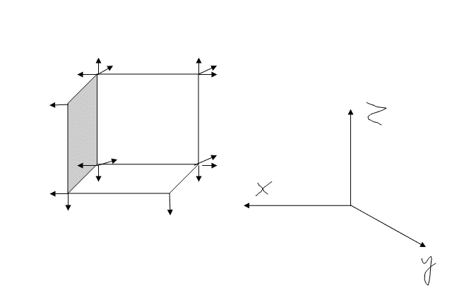

Summary:: You have a spacecraft the size of a cube (2x2x2 m^3, m=3000 kg. It has 24 thrusters (2N each) and one main engine. For preparing your spacecraft for maneuvers, you want to rotate by 180 degrees. For the rotation, you'll use n=4 attitude thrusters per burn.
What am I doing wrong? Please read below.
I have this project assignment. I'll say the questions and explain what I did.
Q1) Minimum total maneuver to slew the spacecraft by 180 degrees=? (assume center of mass is in middle of cube).
Answer: I used this formula:
tb=sqrt(θm*Iz/n*F*L), where I already have θm=180 degrees or pi, Iz=(2*m*(b^2))/3=8000 kg*m^2, n=4, L=d/2=0.5 m, F=2N.
From all these I get tb=79.26 sec. So tm=4 (the thrusters)*tb=317.04 sec.

Rewritten problem:
Problem: You have a spacecraft the size of a cube (2x2x2 m3, m=3000 kg. It has 24 thrusters (2N each) and one main engine. The main engine is perpendicular to one of the faces of the cube and each has 4 attitude thrusters.
For preparing your spacecraft for maneuvers when reaching Mars, you want to rotate it by 180 degrees. For the rotation, you'll use n=4 attitude thrusters per burn.
Questions:
Q1) What is the minimum total maneuver to slew the spacecraft by 180 degrees? (Assume center of mass is in middle of the cube).
Q2) It is given a=0.95 and e=0.85. What is the temperature (in Celsius) when reaching Mars, when you know that only one of the faces is illuminated by the Sun and that the heat flow is distrubuted homogeneously?
Q3) The power which is generated in the spacecraft can be considered as input power for the radiation balance. How much power (in Watt) should be dissipated inside the spacecraft , in order to achieve 0 Celsius?
Note: All formulas and types used in the answers below are provided on slides by my professor.
Answers (what I calculated):

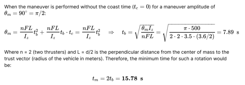

Q1 Answer: In order to find the minimum total maneuver, I firstly used this formula:
tb=sqrt(θmIz/nFL), where
tb = durationof burn (sec)
θm = minimum angle of rotation (rad)
Iz =moment of inertia around the rotational axis (kg m2)
n = number of thrusters used for the maneuver
F = thrust for each thruster (N)
L = perpendicular distance from the center of mass to the thrust vector (m)
I already have given from the problem that I want to rotate the spacecraft by 180 degrees. So I used θm=180 degrees=pi.
Iz is given by the formula Iz=(2m(b2))/3=8000 kg m2.
n=4 is given.
L=d/2=0.5 m
F=2N is given.
So, tb=sqrt(θmIz/nFL) = sqrt((pi*8000)/(4*2*0.5))=79.26 sec.
In order to find the minimum total maneuver time, I used this formula: tm=ntb, where
tm = minimunm time (sec)
So, tm=ntb = 4*79.26=317.04 sec.

From the rewritten problem: "Q1) What is the minimum total maneuver to slew the spacecraft by 180 degrees?"
Answer: The minimal total maneuver to slew 180 degrees is 180 degrees.
Please be careful in your statement of the problem and do not force us to figure out your calculations just to know what the real question is.
Your rewritten problem in Post #14, still has many issues which make it very hard to understand. Let me try to point-out/explain the issues I can easily spot.
My comments are in square brackets and bold:
[Does this mean there are 4 thrusters on each face of the cube? What direction are they pointing? Do they operate as 2 pairs on each face, to give clockwise or anticlockwise motion about the face’s principle axis? Or maybe their directions can be adjusted.]
[Are the ‘attitude thrusters’ the same as the ‘24 thrusters’ previously mentioned?]
[I don’t understand which axis the 180 degree rotation is about, which 4 thrusters are used and which directions they fire.]
[Seem like (a) diagram(s) is/are missing?]
There are eight corners on a cube. Each corner has three edges that meet there. If we had three thrusters at each corner and aligned them each to fire along an axis parallel to one of the edges, that'd give us 24 thrusters as specified.
That design would make the moment arms (about the center of gravity) equal to half the dimension of the cube (d = 2m, L=1m).
More realistically, one would likely optimize by arranging the three thrusters at each corner in a plane normal to a line from corner to center. Then the three thrusters on a corner would be at 120 degree angles to each other. The moment (lever) arm about the center of gravity would then be ##L=d\frac{\sqrt{3}}{2}=\sqrt{3}## meters. That's about a 70% improvement in performance.
If the professor has this latter interpretation in mind, he might be visualizing a rotation around a particular axis (an axis between the mid-points of two diagonally opposite and parallel edges). He would then assume the use of thrusters on the four corners not on the two selected edges. Finally, he might assume that one thruster on each corner is lined up exactly right for the intended rotation.
For a four-thruster burn, I believe that this choice of rotation axis and thruster selection optimizes the angular acceleration.

jbriggs444 said:
In any case, once we substitute in for ##\alpha## in ##t=\sqrt{\frac{2 \theta}{\alpha}}##, we get $$t=\sqrt{\frac{2 \theta I_z}{nFL}}$$This does not match your proposed formula: tb=sqrt(θmIz/nFL). As predicted, the latter is missing a factor of two.
This comes out right if you account for the fact that you need time to decelerate back to not-rotating.
Likes Steve4Physics and jbriggs444
But then you would need to multiply by 2 to get the total burn time.
Either way, of course, we are left guessing at the reasoning used by @Viii since he hasn't told us what he was thinking.
We do have a clue though. When calculating the result, he uses ##\theta_m = \pi## (180 degrees). Not 90 degrees. And he does not multiply by two. He multiplies by n instead for some reason.
