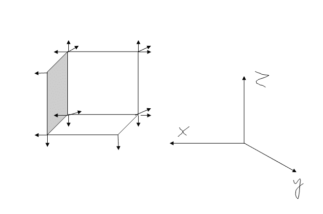

Please check the attached file. It's a drawing I did of the shape on the exercise paper. It doesn't state which axis, so I assumed and took the z axis. I also added one similar exercise the professor had in the past (see second attachment please).

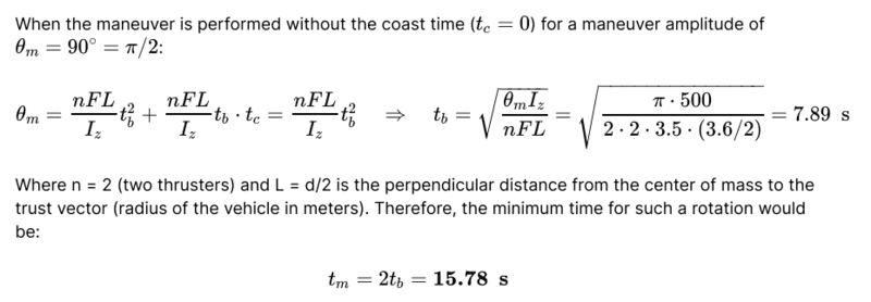

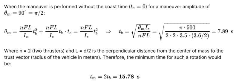

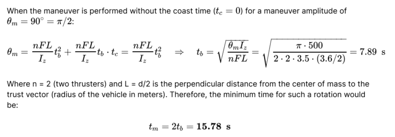

Somehow. It was given. You can see it also at the second attached file for another exercise, for a 90 degree maneuver.

Hello. I assumed the z axis. I chose it randomly, since it's not stated anywhere which one shall I take. By the way, love your answer. It's very detailed.
I took the same formula as in the picture attached (it's a similar problem). But now that you made the analysis it makes more sense. It was 90 degrees there, so pi/2, so the 2 factor was probably gone by that. Since now we have 180 degrees, we need the 2 factor. Right?

Reading from the attachments...
The first attachment shows a set of coordinate axes (x, y and z) drawn isometrically beside an isometric drawing of a portion of the skeleton of a cube. Unfortunately, the axes are drawn slanted differently from the cube. However we can see that the "z" direction is normal to the "bottom" face of the cube.
So we know the direction that the axis of rotation points -- vertical. But that does not answer the question I was trying to ask.
Are we considering rotation around a vertical axis through the centers of the top and bottom faces?
Are we considering rotation around a vertical axis along the center line of the right hand face?
Are we considering rotation around a vertical axis along one vertical edge?
