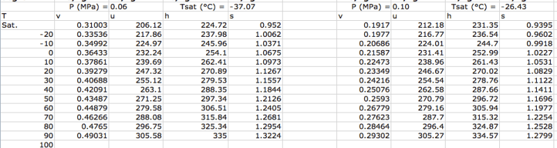

So I have this surface that I am trying to make approximations on. Now I have values for [itex]f(x_1,y_1)[/itex] and [itex]f(x_2,y_2)[/itex]. I want to find the value of [itex]f(x,y)[/itex] where x and y lie between (x1, x2) and (y1, y2). I am willing to assume that f changes linearly in both x and y for this small interval. Would the appropriate interpolation function then be
[tex]f(x,y)=f(x_1,y_1) + \frac{f(x_2,y_2) - f(x_1,y_1)}{x_2 - x_1} *(x - x_1) + \frac{f(x_2,y_2) - f(x_1,y_1)}{y_2 - y_1} *(y - y_1)[/tex]
I feel like it would be ... but I also feel like it could be
[tex] f(x,y)=<br /> f(x_1,y_1) + <br /> \sqrt{<br /> [\frac{f(x_2,y_2) - f(x_1,y_1)}{x_2 - x_1} *(x - x_1)]^2<br /> + <br /> [\frac{f(x_2,y_2) - f(x_1,y_1)}{y_2 - y_1} *(y - y_1)]^2<br /> }[/tex]What do you think? I am really confusing myself here :smile: First or second one?

Actually, I have been Googling around and got so confused that I came here :redface:
Let me post an example. I have a bunch of data tabulated as follows,
You can see that for some value of "P" in the header (for example P = 0.06 MPa) we have a bunch of Temperatures and corresponding values of properties. For example for
P = 0.06 MPa we can scroll down to T = 10 and see that the corresponding value of v is
v = 0.37861.
Similarly we can see that for P = 0.10 MPa and T = 30 we have v = 0.24216.
My question is what if I want to approximate a value of v for P = 0.08 MPa and T = 15 ?
I cannot seem to figure out what kind of bivariate interpolation this falls under, nor do I know what determines which kind of interpolation I should use. It seems like I have a regular rectangular grid here... I think. But not all of the tables like the ones above have the same temperature range. But working with the 2 above would be a good start.
v = 0.37861.
For these kind of thermodynamic problems, there can be different formulas for different input variable ranges e.g. PV = mRT is one simple formula. However, heat transfer has different formula for different ranges of the inputs.
Best possible thing I can think of at the moment is getting sufficient information to construct a plane. Two points A and B have infinite number of planes. If you get one or more points, you make a plane and use the points as estimation. This should work for smooth graphs without discontinuities.
