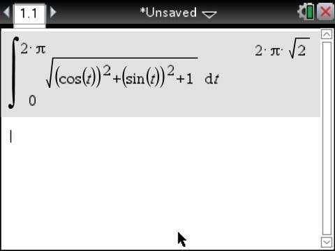

find the length of an arc of a helix r(t)=(sint,cost,t) from the point (0,2,0) to (0,5,2pi)
would the interval when integrating be from 0 to 2pi because t in the case is (z=t)? please say yes. please say yes.
ineedhelpnow said:
find the length of an arc of a helix r(t)=(sin2t,cos2t,t) from the point (0,2,0) to (0,5,2pi)
Yes.
ineedhelpnow said:
really? is this right?
It would be right... but I'm only just now noticing that your function is not a helix.
How does it get to $y=5$? (Wondering)

How about $r(t)=\left(\frac{3t}{2\pi}\sin(t),\ 2+\frac{3t}{2\pi}\cos(t),\ t\right)$?
what about it?
you would differentiate and pull out a common factor and simplify the sin and cos to 1. and then add the extra 1 and take the square root.
ineedhelpnow said:
what about it?
Did you really differentiate it?
How about the factor $t$ that is in both the x-coordinate and the y-coordinate (which is an integral part of a helix)?
factor it out before you differentiate.
Can you show that?
Edit: Perhaps I should say: you can't.
why can't it be factored out? :confused:
I'm not entirely sure what you mean, but I'm going out on a limb and say: no, it can't be factored out.
What is the derivative of $t \cos t$?
ineedhelpnow said:
cos t - t*sin t
There you go!
No factoring out before the differentiation.
ineedhelpnow said:
what about it?
:D soooo you can just do what i said earlier. by differentiating. pulling out a common factor of 3/2pi and---- oh i see what i did wrong. (Giggle) made a mistake with the differentiating part.
